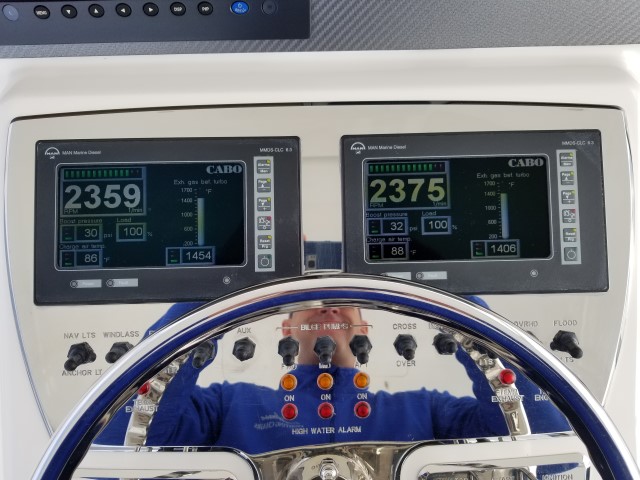

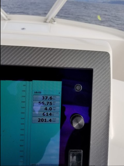

    After a little yard time to have thruster tube glassed in and old bottom paint sanded down and 2 coat of Cukote it was time to open it up on the run home for 1 to 2 minutes. See attached pics. RPM's of 2359 Port and 2375 Stbd. Coolant temps were 192/190 respectively and 80gph at 100% load. 37.6knots. 20171006_105509 (Small).jpg 20171006_105512 (Small).jpg

  14. Capt J
    14,892
    Those are all perfect numbers. I like to see 2350 rpms on Man's even when they're rated at 2300.

    Newly launched with a squeaky clean bottom ... those are good numbers. That "room to spare" will soon disappear with any growth or added load.

    Hang on , when we have finished backslapping --------
    Load never shows more than 100%. It can,t .
    Therefore what was the rpm when the load just went from 99 to 100 .
    How do we ( you ) know it's not actually overloaded in the screen shot ?
    EGT at 2359 and 2375 would be nice to see as overloading would see a rapid rise into dangerous territory.
  18. PacBlue
    PacBlue Senior Member
    Jan 9, 2009
    2,002
    Dana Point, Ca
    Not so fast with all you naysayers.
    The load you see on your screen is a calculation and does not give you a full picture of the actual performance map. There is margin available in terms of fuel delivered to burn that you are not seeing and the really nice cushion of rpm - 59 port/75 stbd which is 67 rpm average.At this condition, exhaust temps are irrelevant because I can assure you they will be in spec.
    Running real nice and plenty of cushion, bottom growth in the PNW is not the same as out East and you are not going to scrub that rpm in this well maintained boat. The boat is already in an owners possesion and has his gear onboard for a loaded condition.
    I would like to see a two way average to eliminate any current effects.
