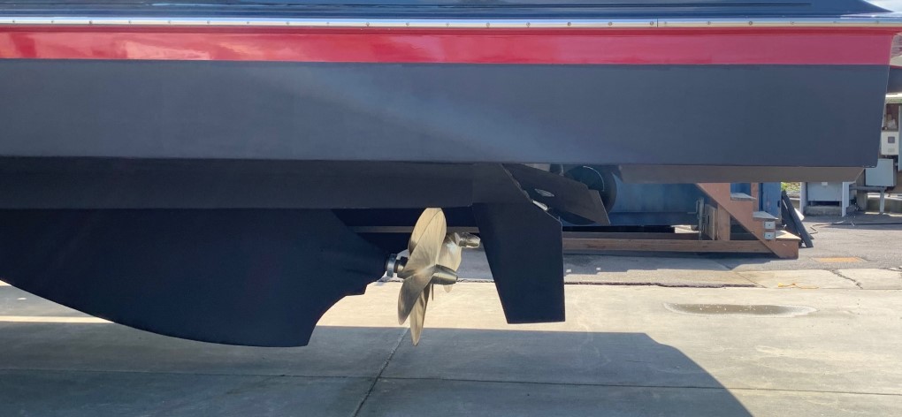

    Looks similar to the one we sea trialed, it had twin gens. Deceiving when you look at the center line distance on the engines compared to the stern pic in the yard. They could have went outboard a bit more with the engines. Unless you want a fast cruise those 3406E's are a good engine for that boat if speed is not an issue. Seems we saw around 16 kts cruise, but had a trim tab stuck in down position, which bombed out the sea triaI. Boat was really light on fuel, water, and equipment. No tender . Think the later models went to the C18"s for a faster cruise, but still great inline engines for more room in the ER. They may have kept the engines tighter because of exhaust getting into the tunnels. The underwater exhaust ports are outboard and forward of the tunnels, one of the outlets on each side of transom are probably low rpm exhaust ports, the other two could be for the gens.

    Lazarra's had this same issue, some added a fence (strake running on the inside to help deflect it). I was on a survey of a 68' that didn't have them and the captain went to get on plane quickly. The engine surveyor got so scared he ran out of the engine room and called for ALL STOP. The engines were vibrating so bad, he was afraid the motors were going to rip off of the stringer. It's not the underwater exhaust, it's the placement of the underwater exhaust. Sunseekers have underwater exhaust and NEVER have this issue or fences.

    I've seen a few Lazzara's over the years that have eventually snapped shafts from it over time. Most surveyors cite improper blade tip to hull clearance. Lazarra did it on all of their boats to have as little shaft angle as possible and efficiency (which they are efficient).

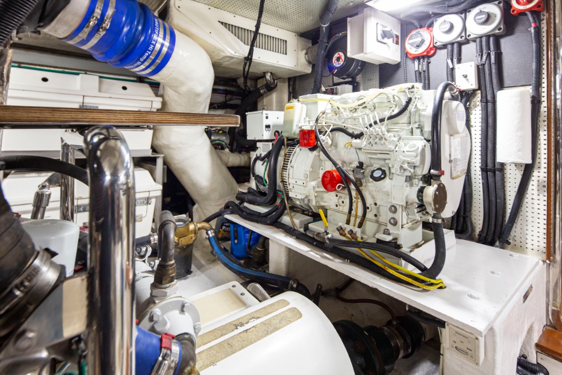

    Where are the generators? The early 2000's Marlow I ran had them mounted outboard of the engines. Of course it had stand up engine room height, but the engine room length from bow to stern was short and there was minimal crew cabin. Marlow put all that space up into the cabins where he 'beat the competition'. Of course years later there was a decision on that boat to replace the generators. I asked the next captain how they did it with them being outboard of the engines. He said they stripped them to the block and got them out of the boat with lots of effort. The new ones were installed by stripping them to the block and reassembling them in the engine room. Cost a fortune and the new generator warranty was crumpled up and tossed in a garbage can.
  13. Cowger
    Cowger Member
    Nov 14, 2019
    47
    Sacramento, CA
    On this 2002 model, they appear to be mounted aft of the engines, at least as shown here on the starboard side. The listing specifies twin 20kW NL, so I'm assuming that the other one is on the port side; no pictures show it, though.
    I'm planning to step on board this boat next week and should have a better idea of the overall layout then.

    The 65/70 Marlow's I've seen had twin gens , one aft of each engine. Just inside the er entering from the crew quarters.

    Going back to the Marlow I last commented on (#95 above), The gen sets were behind the mains, In boxes, slightly over the shaft logs.

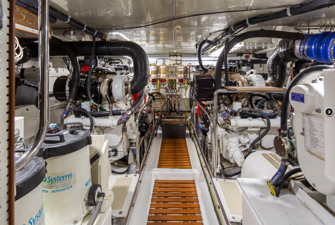

  16. Capt Ralph
    14,568
    On the '04, 71', from post 84 above, still some good room between the mains, the gen set were outboard of the mains and the batteries were ,,, who knows where. Still I felt there some great space between the wheels.

  17. Kapn
    Kapn Member
    Aug 31, 2009
    77
    Annapolis
    Aft of the engine makes a lot of sense. Looks like good access around it. Why no hush box?
  18. Cowger
    Cowger Member
    Nov 14, 2019
    47
    Sacramento, CA
    It's a good question. One possible answer is this part of the listing: '3" Lead / Foam Engine Room Insulation' -- perhaps the thinking is that by insulating the whole engine room, it's less important to hush the generators?

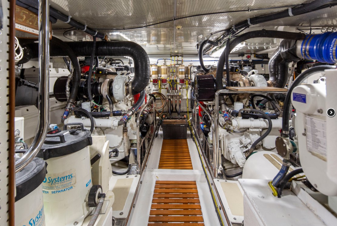

  19. Capt Ralph
    14,568
    Looking at the top picture in post #86, how much shaft is between the cutlass bearings?
  20. Cowger
    Cowger Member
    Nov 14, 2019
    47
    Sacramento, CA
    Here's the best picture from the listing which would show that:
