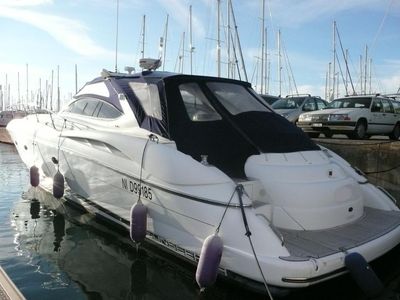

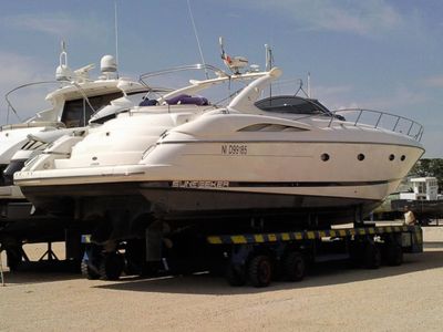

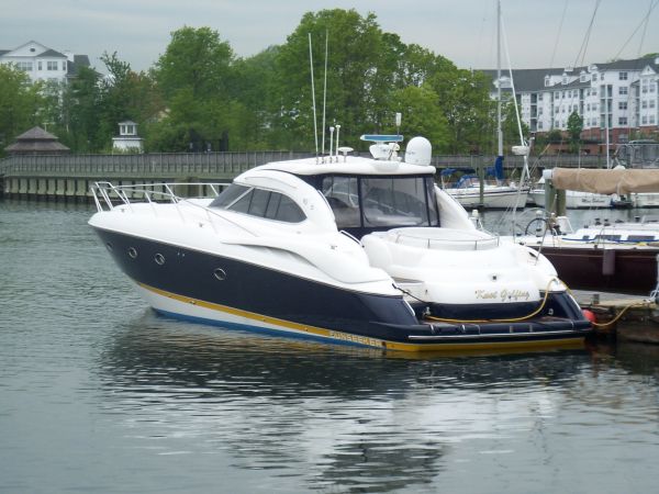

    the boat i can pay (financials is not good enough for me to buy a newer boat this size) is something like this one. 58' predator. 12 years old. Yes, 12 ...
    I like those engines , love the style, seems to ride very well, and people say these older models were better and more meticuloslly built than newer ones. (better economic times, more time, less stress, less competition, first predators offered, etc etc ). Now all is about money, china, competitiom, low cost whatever it takes ... I am sure you understand what i mean. (My english doesnt help me)
    I cant tell for sure if these older SunSeek's are better than modern ones, but as far as i see this 10 years old models are very solid and good shaped .... (perhaps i am wrong ...)
    the animal i can pay like these on the pictures ...

    I cannot say that the older sunseekers were built better than the newer ones. The sunseekers you are looking at are built ok and there is nothing wrong with them, however Sunseeker has learned a lot along the way and implemented that in the newer ones, I also think the build quality is a little better.
    I was on one of the early 74' Manhattens and my friend ran another 74' manhatten (hull #1). Those boats had a lot of build issues...... The teak aft decks were not sealed properly and a lot of water would leak into the engine room and all over the motors, and the deck would flex. The interior ceiling panels would fall down all of the time in 3-5' seas and break all of the wires off of all of the light assemblies. Factory service in the US at the time was very poor in the way they handled the problems and the customers. They built too many at the same time, and didn't have the proper warranty support or parts support to keep up with the amount of boats they were selling IMO. A friend of mine ran a 2010 74' Manhatten and they'd still take months to fix relatively small warranty problems, but they seem to have the parts I need in stock.
