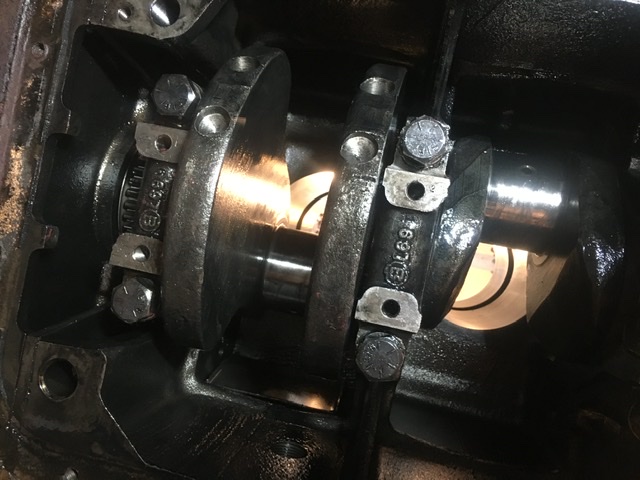

  7. cleanslate
    cleanslate Senior Member
    May 29, 2018
    1,661
    Cherry Hill, NJ
    FB43626F-821C-4FAC-8A70-BFE4AF8FCFA3.jpeg Some bearing caps…
  8. Capt Ralph
    14,571
    Work and family????
    Yes, these do get in the way sometimes.
    Bosses and wives (chillins?) just don't understand.
  9. Capt Ralph
    14,571
    That is the same for the in-line 6.
    Now imagine, half of that for a V block rod bearing.
    Now you may understand my hard for the straight blocks.
    cleanslate likes this.

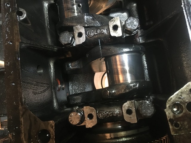

  11. cleanslate
    May 29, 2018
    1,661
    Cherry Hill, NJ
    E26BC9FB-1766-4BA4-B767-1649B1EDC5A9.jpeg Here’s the front bearing and seal .

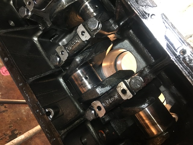

  12. cleanslate
    May 29, 2018
    1,661
    Cherry Hill, NJ
    EF729913-05BF-4D9C-95E2-5FFC942F055D.jpeg And the end , 4 and 5.
