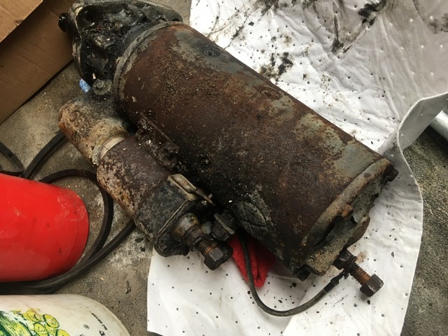

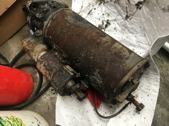

    Starter gear and con looked brand new,
    The exterior is rusty as hell solenoid looks like crap. This starter is real low up against the engine stringer and fuel tank , impossible to remove after the engine is put in place…

    That starter has the rotating head also. Ensure the new starter has its nose aligned in the same position before mounting.
    Invest in a new starter also (not rebuilt).
    Ole Bert 32V starters have not been touched since we have owned her. Could be original.
    Not pretty, but never failed.
    One day, converting to 24V MT50s. These will be new then. a few bux extra but I'm not going to touch them again for at least another 20 years.

    Got tired of holding down the starter button for two or three minutes…
    Things were looking spooky rusty and what not.

    You have to remove the engine or tear it down to get the starter out? Sounds like it is a PITA under any circumstances. I think I would buy a new starter from a reputable manufacturer AND have it bench tested before installing. It would royally suck to do all the work you’re doing then have a starter issue.

    I forgot to mention, my mechanic friend preferred to bar the motor from the flywheel. He has a home made gear that goes in where the starter is , like a stater cone with a stater gear and a 1/2” drive on the out side. that’s how we took the liners out.
    That’s why I pulled the stater out , and got a good look at it.

    After I removed, just had the starter left to remove. Came off easily. Had an oil leak above, kept the nose from seizing into place!
    Why DD used two 15/16” bolts and one fancy 12 point PIA bolt baffles me to hold the stater…I now have a 12 point socket set.

    Usually, you can not reach that bolt with a wrench, only a socket with extension.
    A better 12 point socket/bolt can center, insert and apply more torque than a regular bolt head.
    Good ideas when working in the dark or out of sight on an old rusty bolt.

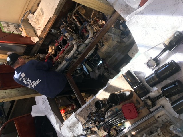

    3F9471DC-8F5F-46D6-BC66-0045E7568295.jpeg The professor(mechanic) pulling out the last piston …..

    Oh so now the truth comes out, your just the gopher and picture taker in this endeavor.:D:D:)

    Ha ha! One day of work of work on this thing , then I need two days of rest and recuperation just to start all over again!
