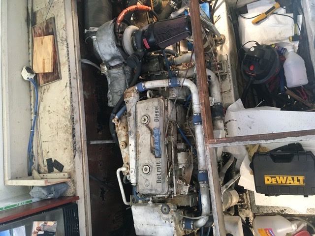

  11. cleanslate
    cleanslate Senior Member
    May 29, 2018
    1,661
    Cherry Hill, NJ
    87D5C37F-8421-4341-B30D-B769BB362067.jpeg One more…
  12. cleanslate
    May 29, 2018
    1,661
    Cherry Hill, NJ
    Lol, yeah I'm keeping her away and off the boat till May...
    Yes, CR, time for lots of love and attention down below. Everything above the hatches is all redone, interior, exterior etc. Now it's time for the motors and bilge.....

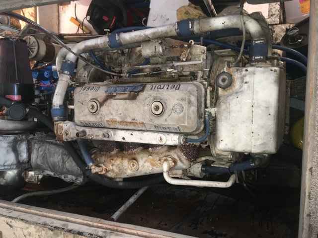

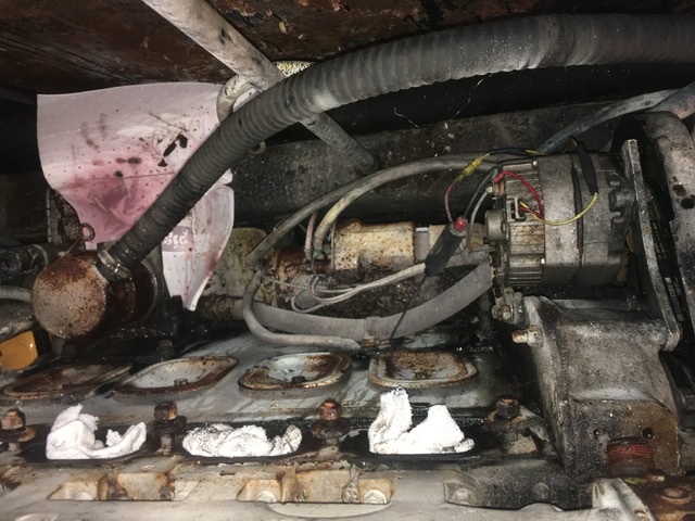

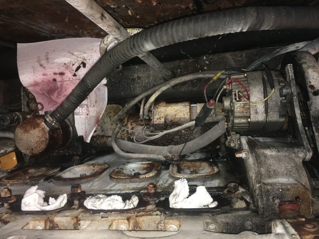

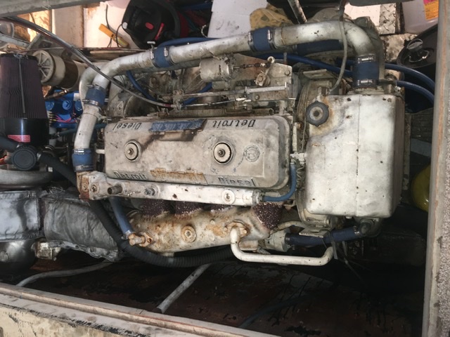

  13. cleanslate
    May 29, 2018
    1,661
    Cherry Hill, NJ

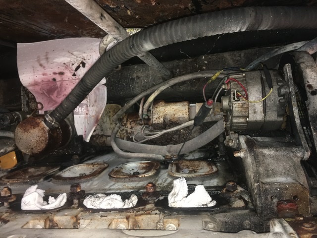

    I did make progress last week,
    Entire exhaust section is off including turbo and inner cooler..
    what do I do with the old rusty coffee can oil collector down on the side of the block? It goes to the Airsep.
    Is there a newer design I should install or clean up the rusty can that I’ve got I think it’s still OK it doesn’t seem to be leaking. E48BF289-8F53-40A4-A4A0-CCC8A46B7DDE.jpeg
  14. Capt Ralph
    14,568
    You have asked about that before. Been a couple of years??
    Got it now; You have no valve cover vents. Usually, I see the AirSep drawing crankcase fumes from the valve cover vents.
    That can is the engine vent. Baffled and maybe some wire mesh inside.
    Yes, you have to clean it up and save it. I doubt you will find another can like that.
    Ole Cummins just have a pipe coming up. At least you have a lil capture can.
  15. Capt Ralph
    14,568
    How old is your AirSep?
    I see your pic the air filter held on by springs.
    Your Case/Oil filter inside the AirSep may be beyond its service life.
    Oil return line from the AirSep back to the sump real wet?

  17. cleanslate
    May 29, 2018
    1,661
    Cherry Hill, NJ
    yes we did talk about it but I kind of forgot and still have a hard time comprehending what it does but I guess I’ll see you when I pull it off.
    Yes I cannot find a new one. They seem to make aftermarket stuff that looks different.
    But this one seems to be OK I’ll clean it up repaint it clean out the insides and put it back in the service.
  18. cleanslate
    May 29, 2018
    1,661
    Cherry Hill, NJ
    I replaced all the filters two years ago the lines not very wet at all, although I found a little chafe pinhole where the hose was rubbing against the engine and caused a leak so I’ll fix that.
    Previous owner put the Airseps on I say they’re from the 1990s but they’re in good shape on both motors. Nice and clean . I clean and re-oil the filters every winter.

  20. Capt Ralph
    14,568
    I did not type well.
    There is another filter built inside of the big assembly. It separates the crank case fumes and oil. The oil drains and returns to the sump (oil pan) while the gasses and fumes are consumed back into the turbo.
    These separating (coalescing) filters do get saturated with oil gunk and clog preventing the proper operation of the AirSep design.
    Later Walker design have a serviceable filter cartridge where the whole big black junk does not have to be trashed.
    Check your manuals on the Walkers, they do have a hour period to replace that big assembly. Not many folk realizes this and keep going till oil is leaking everywhere.
    I'm fixing to convert a twin an original Walker install to a Racor CCV system because the original Walkers are so old and full of stuff.
