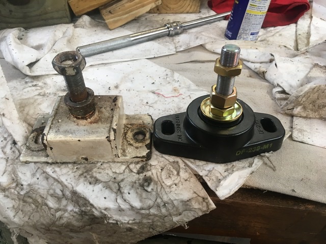

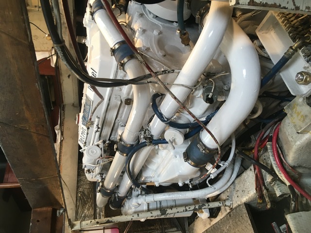

    6B2FB745-A01C-4BDC-BA6E-14BF0DB8F866.jpeg Out with the old in with the new .
    motor mounts four installed rather easily, nice and tight into the existing holes and stringers. You can see my breaker bar in the background, lag bolt tight as can be. That’s a good thing, whew!
    The old one in the photo is one of the better mounts the forward starboard side mount almost completely rusted away.
    Got hammered by moisture /leaks from the heat exchanger tank outlets and hoses from the water pump under previous owners watch.

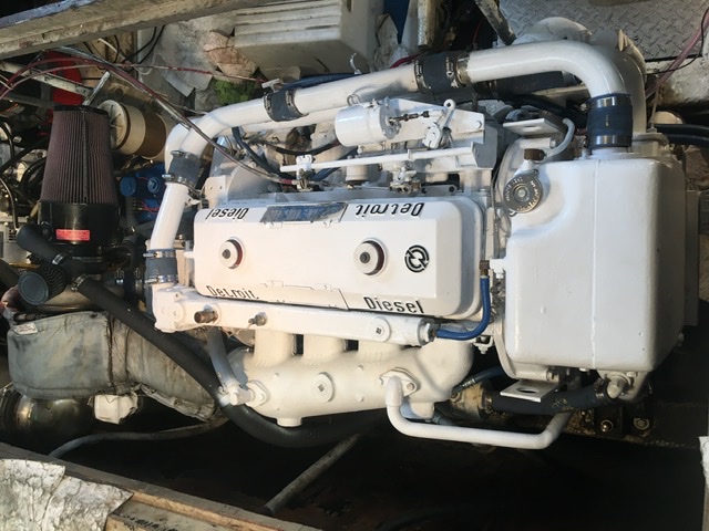

    Getting closer to completion planning on starting her up Saturday with my mechanic!
    Just filled up the coolant system with 7 gallons of DD coolant , good price $12 a gallon .
    Also putting on a spin on oil filter finally getting rid of the old canister filter. Surprisingly the filter price was good from J&T $19.50.
    Still have to finish up the exhaust system, then some final painting.

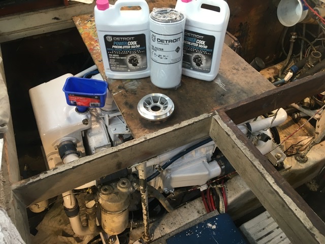

    54743216-3427-4F85-B40C-F893B5B6D61E.jpeg What paint did you use ?
    Here you go.
    Got it from Home Depot works great easy to get and priced right comes in a spray can or brush on version.
    I sprayed all the parts I could at home and then brushed it on on board the boat so the spray didn’t go everywhere and get on the woodwork etc….
    Also coach better with the brush you can get more on in one shot levels out very nice.

    Success! Weather broke in the late morning. Turned out to be a great day.
    My mechanic and I got the engine running in short order ! Thank god . Whew!
    Proud to say we had only one leak on the initial run. Pencil zinc on the sea water intake side of the heat exchanger tank was leaking . We fixed that in short order.
    He had to fiddle with the rack , set the injector timing , set the governor all in proper harmony it was time to fire up the other engine and go out for the sea trail and start the engine brake in time.
    First time I’ve ever had a real professional caring mechanic, of any type , on my boats over the year. Was lucky enough to get my dock neighbor friend to go along and run the boat at times while I could spend all the time I wanted with the mechanic in the engine room.
    We spent about two hours running the boat at 1000 rpm’s for 30 minutes, then 1500 for 30 minutes or more , then 1800 rpm’s for another 30 minutes.
    He spent the entire time crawling around both motors with his Infrared Temp gun and his hand held digital reflective tape RPM gauge monitoring both engine vitals .
    It was really impressive, to me. The boat ran great ! Shifted in and out of gear really well with minimal hesitation. Both motors idle at 650 rpm’s , docking was a breeze , motors never lagged in and out of gear.
    No smoke , no odors .
    I’m happy as can be, and happy to be done with the project .
    Oh , the other engine , he said is in great shape , fire right up without the block heater which is still not working , its on my to do list. It just needs so love and a can of paint . That’s next winters project .

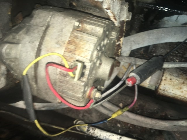

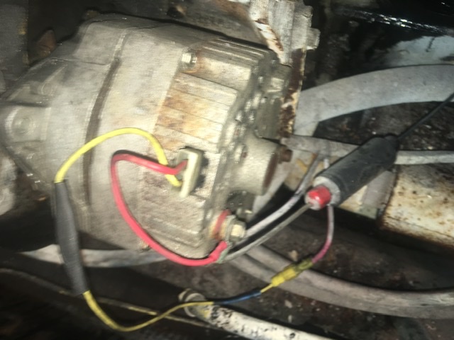

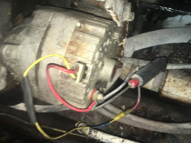

    Oh I do have a problem now .
    Was connecting the battery cables and when I did , heard the low oil pressure alarm going off . Well I guess the ignition switch is on . Ok.
    I go up to turn it off, it is off.
    Something is now energizing my system. Darn ! Now what !!
    so I think about what I’ve done and the only new electrical item I put on is the alternator.
    so I reach over the engine and pull off the little red and yellow plug going into the alternator.
    Now i’m back to normal and the ignition switch and oil pressure alarm works properly.
    turns out I’m getting feedback through the alternator and it’s energizing the ignition.
    Little did I know on that plug-in thing the black wad of looking tape on the yellow wire is a diode within that to keep the alternator from feeding back into the ignition system.
    got one on order now I have to replace that in the next couple days. 184C7FA7-E750-4280-9C93-9BDEE20FDD4E.jpeg

    That fixed it. Alt . is working now. No feed back. $20 part.
