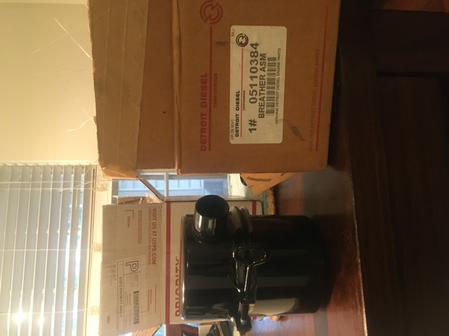

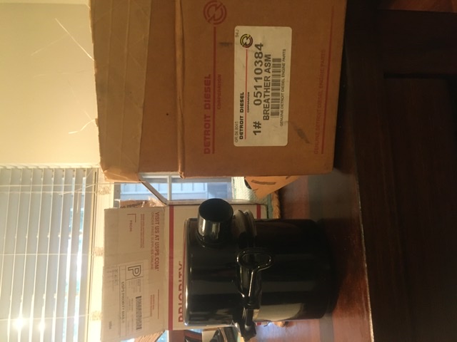

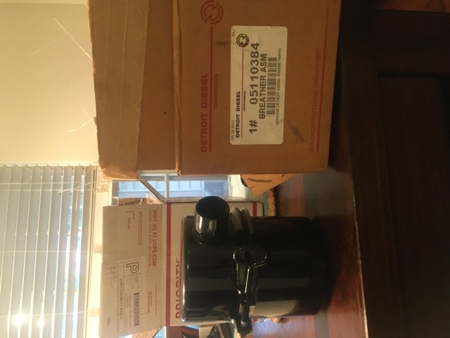

    9A8CEAEE-B5DE-4815-8D4E-2FB3EA52CB6E.jpeg Look what I found …
    Now I can replace my rusty POS…
  5. Capt Ralph
    14,550
    N new case breather can.
    WOW!!!!

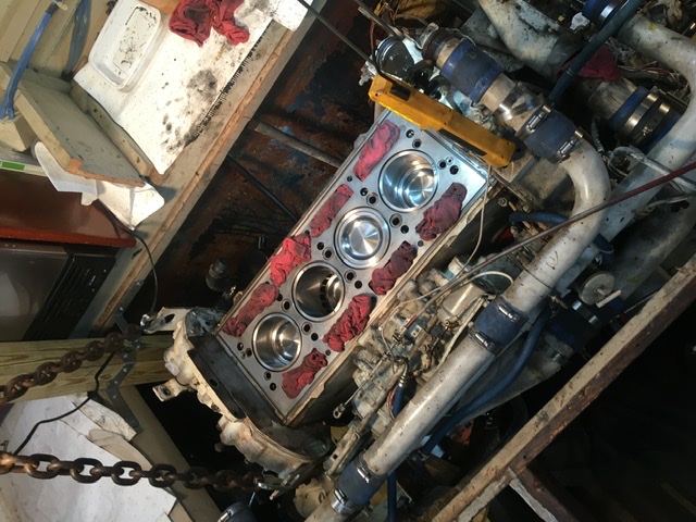

    C2947E97-6C15-46BB-A4A5-1FFC95D07EA5.jpeg A little bit of PB blaster soak and a few taps with the mallet freed up the old crank case filter; new one installed.
    Also set all four liners today by my mechanic.

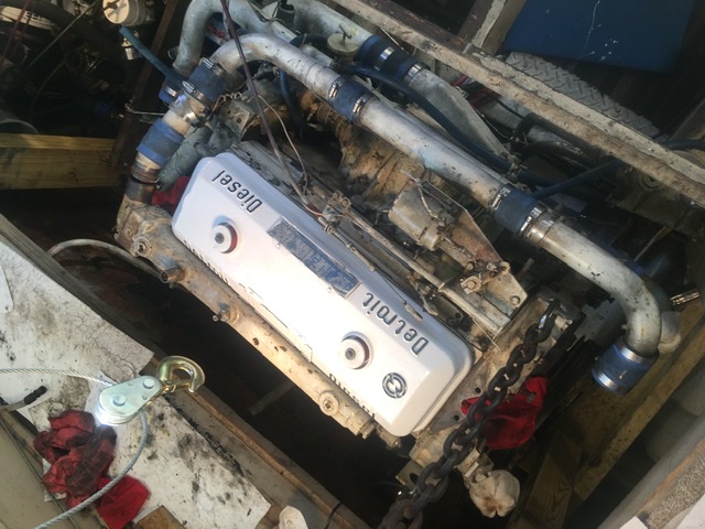

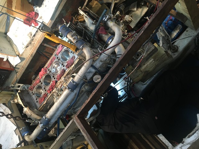

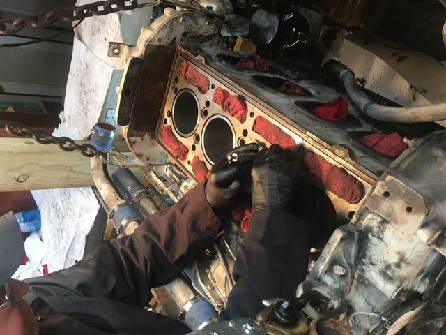

    Whew ! It’s finally going back together!
    My 77 year old mechanic friend Joe, pretty much insisted that he install the pistons and liners. Kind of think he enjoyed doing the work.
    Here he is laying down and reaching up under the motor installing the rod caps.
    Had a good day yesterday. Got all pistons in , oil pump with new pressure springs back in, pick up tube etc. back in. Oil pan on, and new water pump installed. E728CF69-8A7C-4EEB-A978-BB2ED8D3684A.jpeg
    chesapeake46 likes this.

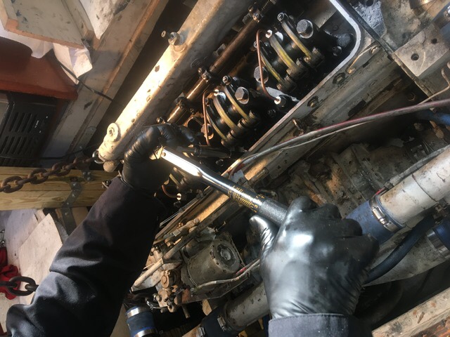

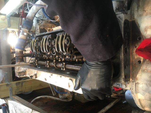

    025A03B9-EBFF-4A73-A4AF-A32676FB498D.jpeg Had another great day today. We got the cylinder head back on , new injectors in -M15-, valve Heights checked and set, New fuel lines in etc. etc.. Thank goodness for Joe the DD mechanic , made it look easy. It most certainly is not.
    he also adjusted the rack of course installed the governor fuel rod etc.
    The rack is smooth as can be from rest to full throttle.

    Got the rocker cover looking nice stands out like a sore thumb I’ve got lots of painting to do!! 244CD62A-E0F9-45C2-AFFE-0524A3669001.jpeg
