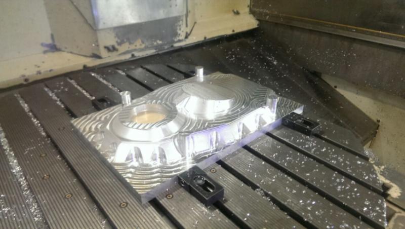

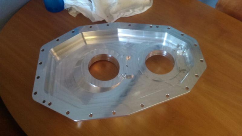

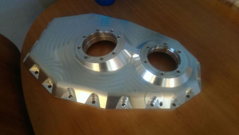

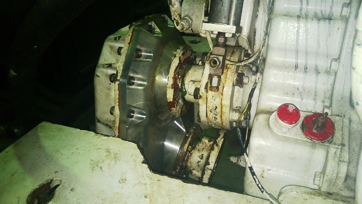

    I had the 1 part of the case made from the 1 complete case i managed to locate. (actually in Florida... had it flewn to Denmark) and had a CNC Machinist specialized in Turbo impellers, 3D scan and machine a new case. It turned out super. Both my drives are being refitted at the moment and are now ready for Run-in test prior to re installing in my boat. I have some nice pics... see below...
    We can reproduce if needed and.. I also have a spare backside case with oil cooler in mint condition. I can have this case 3D scanned and machined also.
