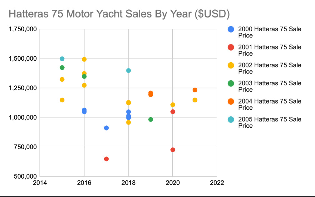

    Ron
    Here's a chart of Hatteras 75 "sold" prices.
    Latest, I think was "Sea Foam" listed @ 1.295M sold 1.150M
    was on the market 57 days.
    2002 Sport Deck - 5 stateroom - cherry int - hardtop
    Amazing to me & the broker who gave me the info, boat had 8400hrs!
