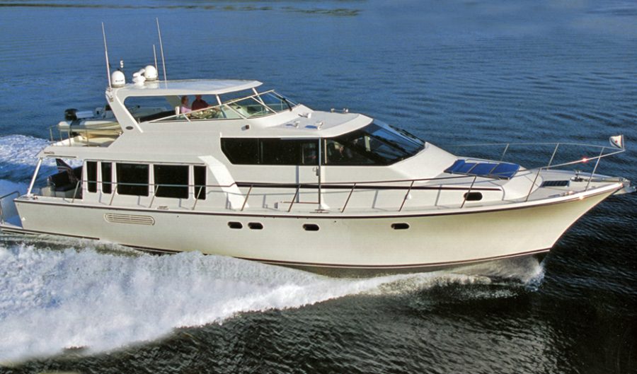

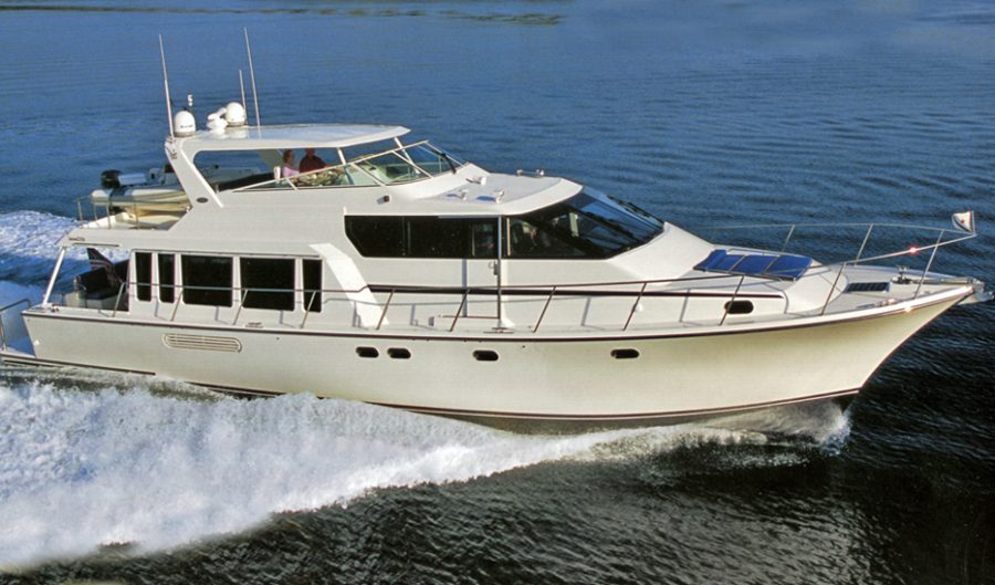

    They were built in Washington. Yes, many of them have been to Alaska. Late serial number boats don't last, the last 2 sold in about 2-3 week time frame.
    These boats are efficient fast or slow. Run 22 kts short trips or go 10kts long distance. I realize SoCal is tight on dock space. It would do everything you want to do in the future.
