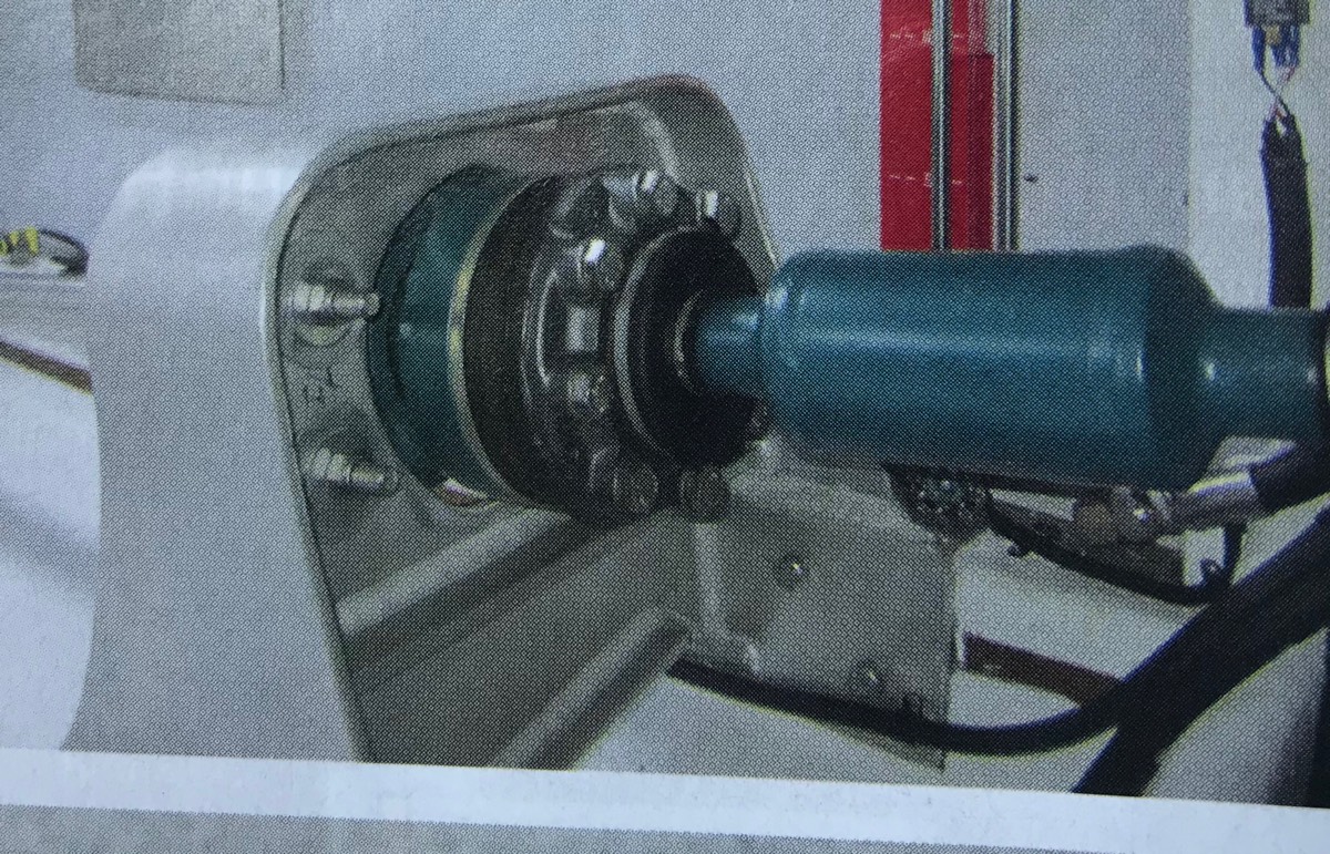

    Some of you may have seen a recent article (Passagemaker?) discussing alignment and vibration. The pic attached is of an "AquaDrive". Instead of bolting to the gears, the prop shaft bolts to the AquaDrive, which is bolted to the stringers and transfers the load from the props to the boat. There is no force pushing on (or pulling in reverse) the engine/gears. This allows for a MUCH more flexible mount which is in turn able to absorb more vibration, and the whole alignment issue is moot, as the tolerances are now huge in comparison.

    I view that product as a sort of band aid for not properly aligning an engine with a shaft line. It allows for miss-alignment which I personally would not accept and adds another component to be maintained/serviced.

    +1 / Poor example of a proper thrust bearing with H.P. limitations

    We managed a GB with a similar set up. I still felt the engines (Cat C9s) vibrate at low RPMs.
    Ate up a lot of room also.
