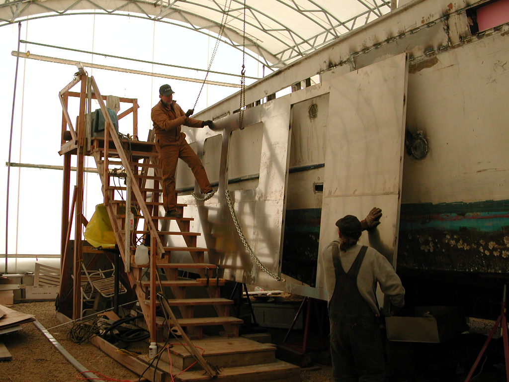

    So, you see I don't post very often, but here I am again. I am here and afloat, this project did not go 'south'. Spoiler alert - project is 99% complete, cruising the Eastern half of the US, living aboard. Still lots of trim work and accessories to install, but she runs great, comfortable and relatively easy on fuel (1650 hours on the new John Deeres).
    We'll bring you along a bit at a time with the completed boat pic a little later. I should warn the Roamer purists, this is not what you are looking for. The state of Michigan insisted that of there is an HIN, it remains a 1970 CC Roamer; so it is.
    The boat was stripped to just a hull and trucked to Michigan. Set up in our back yard. Did I mention that we have a sizable back yard? Then 16 months of cleaning, measuring, and design work. Lots of correspondence between the Naval Architect and us resulted in a plan. June '06 was Aluminum shipment #1. Here we are clamping up the fore deck. 060907 foredeck clamp-up 4.JPG

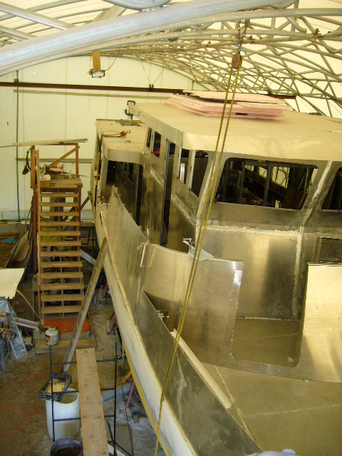

    Late 2004 was purchase and trucking,
    2006 vinyl building is erected so construction can move ahead thru the year. June start of construction.
    Things move pretty quick the first few years. Big parts = big progress. Starts looking like a boat. This pic is about April '07
    Yeah, you are seeing right. no longer a "Roamer profile". I hope Chris Smith is smiling somewhere. At least #0501 is not in a scrap yard.
    It will be '08 before we consider the Superstructure complete, but at this point was can plastic wrap the doors and windows and heat the interior. We can weld from March till November, but when the aluminum is really cold, welding is not impossible, but let's call it tricky.
    Interior work begins winter '07-'08.

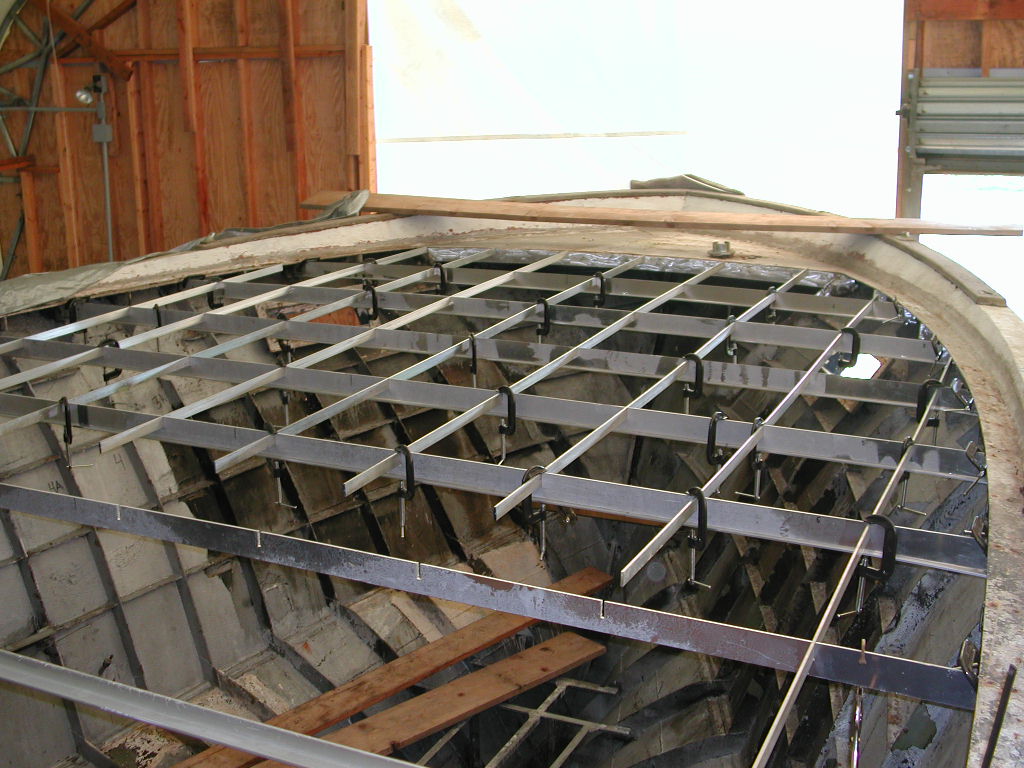

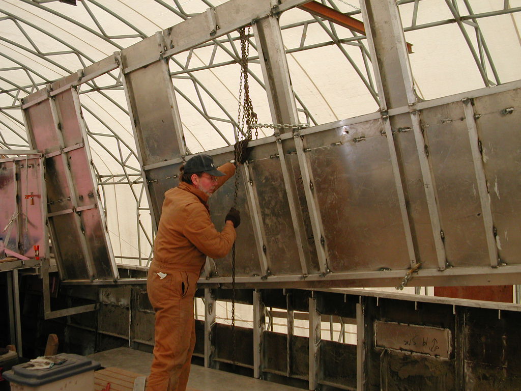

    Maybe this is a little out of sequence, but i found a couple pictures that show the process getting to the last post.
    Weld sub assemblies in the heated garage. Slide them out in the snow. Lift into place.
    This is cold weather so we preheat the aluminum to be welded.

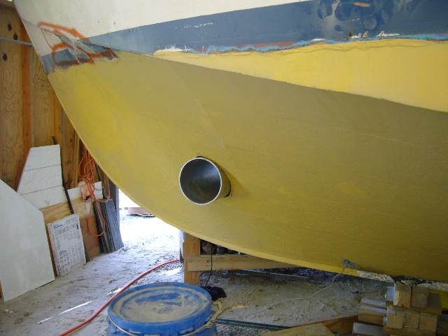

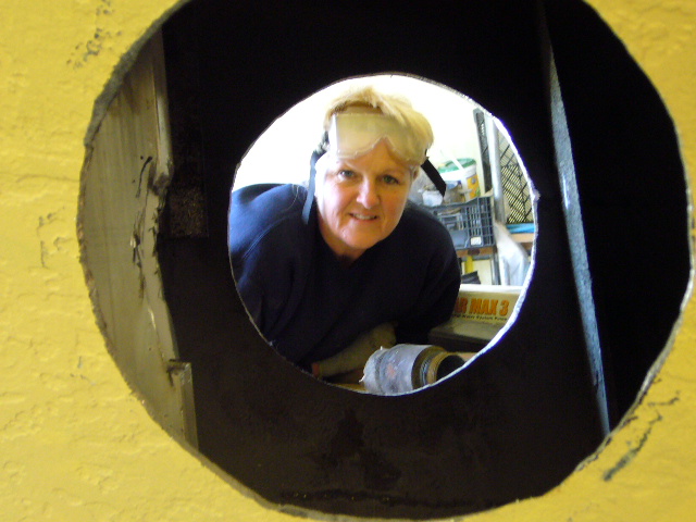

    Once the shell is complete, begin plumbing and electrical. No pics of this because it is truly tedious, uninteresting work. Without interior bulkheads or headliner the work goes pretty quickly. I can say that there are several hundred feet of PEX tubing, manifolds, 3 way valves, check valves, etc. then on to wiring. Easily 2000 feet of wire, from 18 gauge (LED lighting) to 3/0 marine cable.
    Side story for those of you that work on your own boat. There are many projects that make you think hard. BUt I assure you that cutting a 10 inch diameter hole below the waterline WILL make your sphincter pucker.
    Yup, that's the better half staring back at me.
    Good, snug fit and level, whew ! !

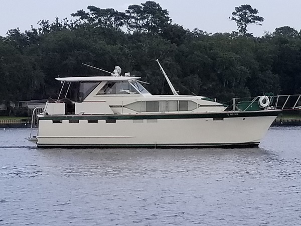

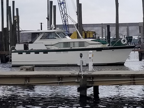

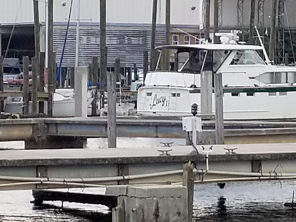

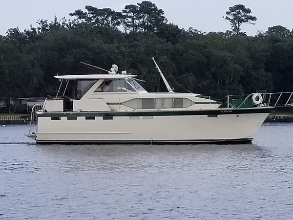

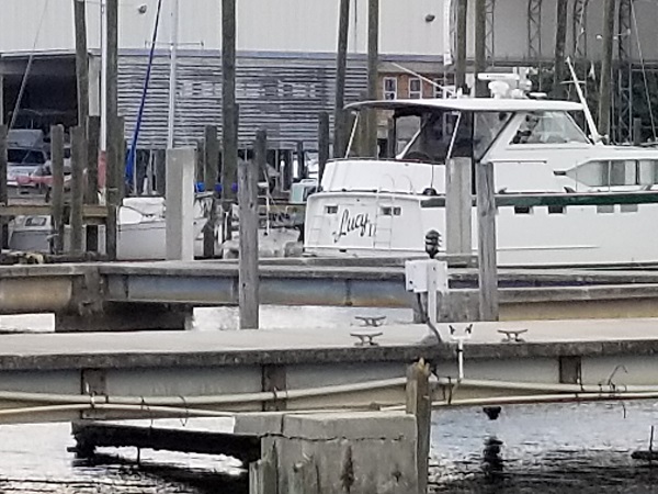

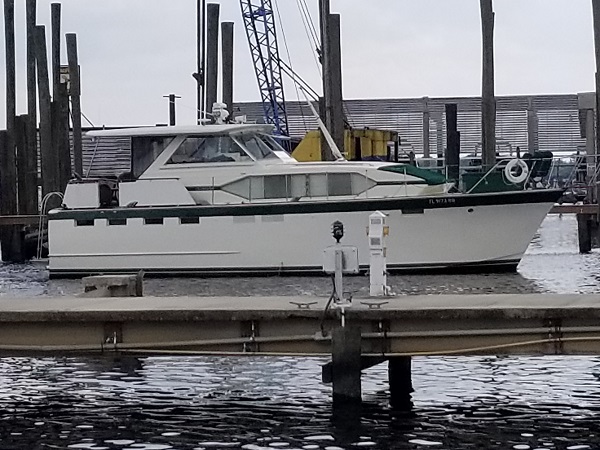

  19. Capt Ralph
    14,582
    No idea of her hull number. Lucy II has graced our area for a few years now.
    She was just inbound to her slip today and I had to stop and watch.
    What a cutie. 20180823_164626a.jpg 20180823_164801a.jpg 20180823_164904a.jpg
