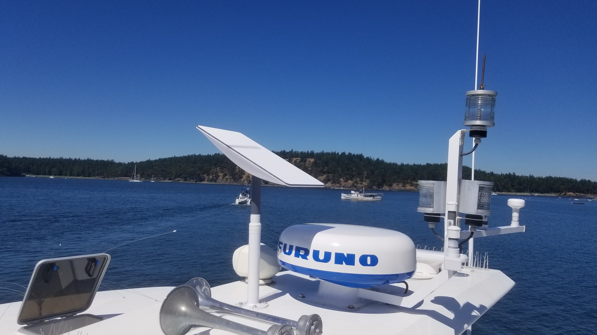

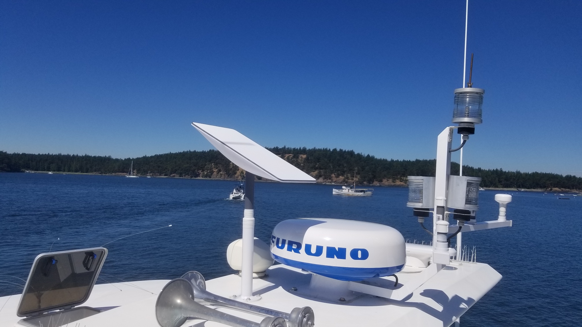

    I realize that you weren't asking for a picture my install, but in case it's helpful, here it is. Our experiences mirror that of MBevins in terms of how happy we are with the service. Total game-changer.

    That's a really nice clean install.
    What can you tell me about the bracket ? How's it fastened to the deck?
  3. TahoeJohn
    TahoeJohn Member
    Aug 8, 2020
    155
    Tahoe VIsta
    Thanks. It's an aluminum tube with a round flange (1/4" thick) welded to the bottom. Four through bolts secure it to the top of my fiberglass radar arch. I 3D printed an adapter to fit inside the top of the tube and marry up with the SL pole end, then waterproofed that joint with tape.
    The cable is fed down through the tube and then inside the boat from there. Cutting off the large SL proprietary connector made running the cable down a lot easier, and then I installed a regular RJ45 connector (also eliminating the SL router in the process).

  4. MBevins
    MBevins Senior Member
    May 23, 2008
    1,265
    Windsor On. Canada
    Very nice, if I have issues with the C3 , I'll remove it and do what you did, I'm hoping not as I don't have access to through bolt and I don't trust self tapping in this application.

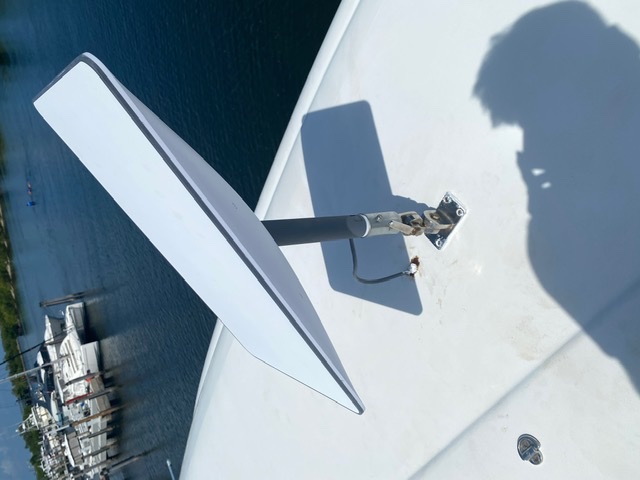

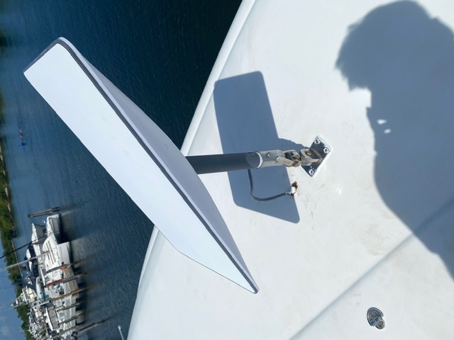

    Installing one right now on the Lazzara 110 I run. On the skylounge roof, away from the maze of antenna and stuff. I recycled an old antenna mount which had a larger fitting. Wrapped a couple of layers of gorilla tape around the Starlink tube to make up for the size difference and drilled a hole thru with a bolt to secure it. The oddly shaped connector require a large hole so we filled the hole with epoxy with a short piece of plastic conduit for the wire filled with sealant. Need to get a clamshell

    1,265
    Windsor On. Canada
    Did you through bolt ? I'm concerned about windage with just a 1inch self tapping screw, I suppose you could put some 5200 under it,
  7. Pascal
    8,949
    No we didn’t. Bedded with 4200. I think it will be fine
