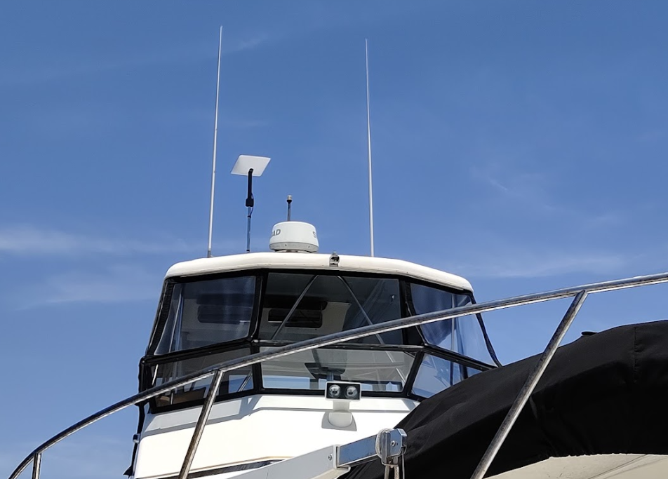

    I've been running StarLink on my 42' Jersey for about a month. It's mounted on my radar arch just above my satellite dome. Pretty much I would answer positively to all the questions asked in the opening of this thread with the exception of turning service on/off since we use the boat year round on weekends. Our router is on the flybridge (lower helm) and I've used it in the slip and on anchor. I've not used it underway however I think it should work just fine.

  13. Brad Boston
    Brad Boston New Member
    Dec 4, 2019
    Huntington Harbor

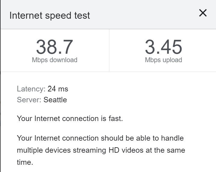

    How much does cloud cover/rain degrade the service? With our Tracvision TV3 antenna and Dish service any substantial cloud cover/rain blocks our service. Had this happen Monday evening at our dock. Just curious if Starlink has similar effects.
  20. MBevins
    MBevins Senior Member
    May 23, 2008
    1,263
    Windsor On. Canada
    I've been on my boat for a month now, I have yet to experience a weather related issue. I will say the quality of signal is directly related to geographical area and population. While in Quebec City I was getting 170mps on average, Heading to Montreal now and it's dropped to about 50mps, Still fully useable .
