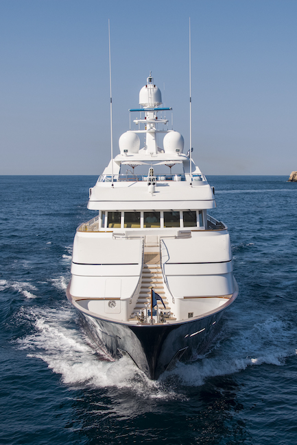

  19. Ken Bracewell
    Ken Bracewell Senior Member
    Feb 9, 2006
    1,782
    Somewhere Sunny
    We mounted our SL panels in the two domes just below the radars, and haven't seen any difference between radars on/off. Installed in October 2022, and have run nearly 10,000nm since.
