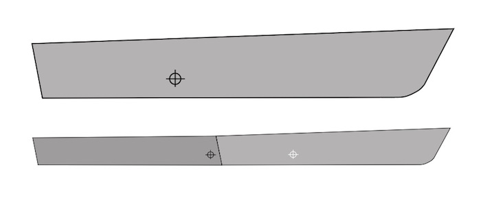

  5. AMG
    5,392
    The cartoonist has now shrunk the boat with stern extension to the same length as it was before, so you can see that the LCG has moved forward relative to the original boat. Laws of physics are the same.
      27.6 KB
      933
  6. Marmot
    Marmot Senior Member
    May 20, 2007
    3,300
    9114 S. Central Ave
    You can make and scale all the sketches you like, it will not alter the law of physics that says the center of gravity will move toward added weight.
    Buoyancy is not weight or lack of weight. Changes in buoyancy do not alter the location of CG.
    Why would anyone insist otherwise?

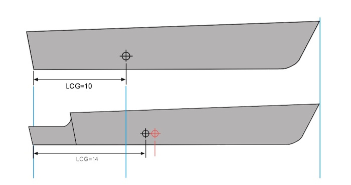

    I'll chime in and say I am onboard with you Marmot, with the minor revision that the Red position looks to be the original LCG position, for illustration purposes only. :)
  13. AMG
    5,392
    OK, here is a drawing with a substantial extension where the new LCG is aft of the original hull. But it is forward of the old position when you scale the drawing down for comparison. So in my world, the Longitudinal Center of Gravity have moved forward in the extended boat, not aft. Capt J is right.

  19. PacBlue
    PacBlue Senior Member
    Jan 9, 2009
    2,002
    Dana Point, Ca
    I would be less focused on length and offer this approach:
    If you are measuring from the Aft Perpendicular (Station '0'), keep this station in the same location for both cases - Hull-Original and Hull-Extended. You will observe that for Hull-Extended, you will now have additional stations aft of Station '0' in the sequence of Minus 1, Minus 2, etc.
    When you do your revised weight study and summing of moments for LCG / VCG / TCG, those weights associated with the cockpit addition are calculated negative (minus) as they fall aft of the Station '0' datum line, which you are holding constant. Fwd of Station '0' are positive values.
    You will then observe that the LCG has in fact moved aft, closer to Station '0', NOT fwd and I believe the math will hold-up, confirming Marmot's dissertation, scale or no scale.
  20. AMG
    5,392
    OK, but your station '0' does not exist in the extended boat, it is a new hull and a new position of the LCG, further from the transom than in the old hull, also in percentage. But this discussion is really on a pre-school level, so I give up.
