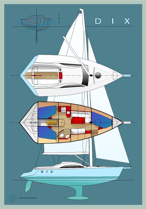

    33´/10 M Sailing Boat
    OK René,
    I appreciate that you like my boats, but I am afraid I don´t have too many sailing boats. But I have one that I made on the same concept as the 95-footer you have seen. But this is only ten meters, Dix in French. I have learned that there is a yacht designer with this name, so excuse me if this should be confusing...
    Anyway, Dix is supposed to be a light weight construction and be able to sail pretty fast in all conditions. On the drawing she might look like a meatball, but in the water she will look more like a space ship... ;)

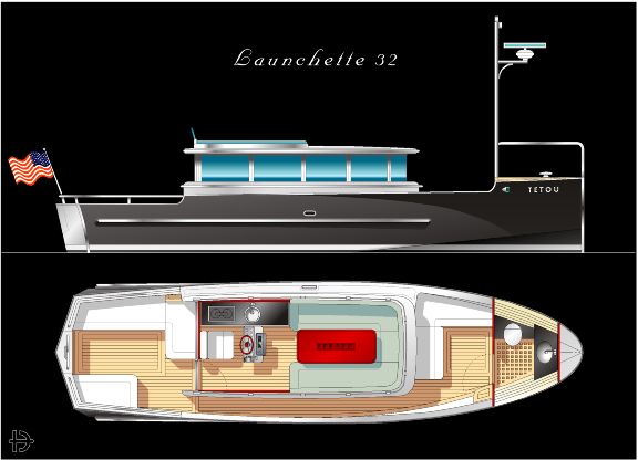

  5. AMG
    5,392
    Launchette 32
    There are a growing number of lakes and inland waterways where traditional powerboats are not allowed. The solution is electric boats and the power can be generated to the batteries by sun cells or fuel cells. In Stockholm a ferry service with biogas/electric propulsion is under development and there are similar concepts elsewhere too.
    Since the power is limited, an efficient hull is needed and what is nicer than to look back a hundred years, when the first powerboats were seen.
    My boat is designed for a speed range of 8-18 knots, the latter with an optional diesel engine of 75 hp.
    It is a dayboat with a convertible dinette, plenty of space to sit underway and a small galley under the sliding glass-top. She has a walkaround deck to starboard for easy entering and to avoid the inside corridor of vintage boats.
    With an almost silent propulsion, this is the way to motor. With grace.

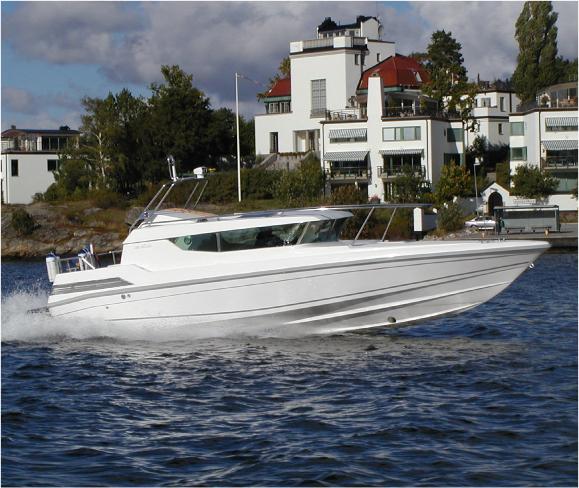

  6. AMG
    5,392
    25´and 32´Commuters
    We are at present building two small commuters, especially focused on how we use boats to get around in the archipelagos of the Baltic Sea. Only outside Stockholm there are 24.000 islands where many have their summer house. To get there (and back) in all weather conditions you need a boat with the comfort of a car. The 32´model has a sliding glass door aft, heating with defroster, bow thruster, trim tabs, wc with tank, cheramic stove, refrigerator, Flexiteek flooring and a lot more as standard equipment. With a diesel engine and sterndrive the cruising speed is between 35 and 40 knots.
    I made the designs two years ago and after two seasons they have today become very popular and well known boats around Stockholm.

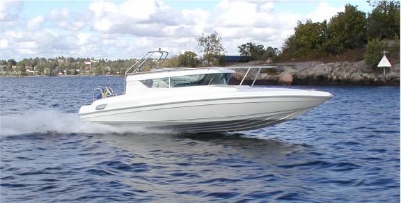

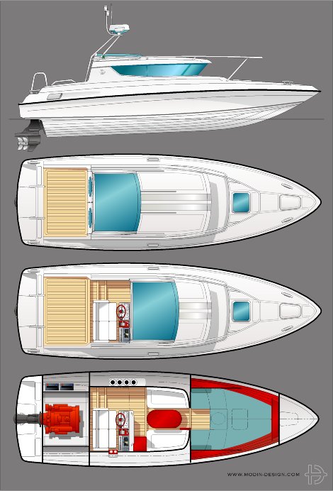

  7. AMG
    5,392
    The 25-footer is a little more avantgarde. With the helmsman back in the gravity center and passengers one step down forward to reduce pitching. Sits six under the hardtop and sleeps two to three in the lockable front cabin.
    A sliding glass roof opens up and allows the driver to stand up. Should it start to rain, it takes seconds to close it again without reducing your speed. In the back of the cockpit is a drop down canvas wall.
    With heating, defroster and all you need to go. Fabrics from Sunbrella, Flexiteek floors and superglossy mahogany panels, this is a top quality boat made in hand layed up GRP. Both the 25 and 32 are designed on existing well proven hulls.
    The 25 is delivered with both diesel and petrol engines of 240-320 hp for top speeds above 50 knots!

  8. AMG
    5,392

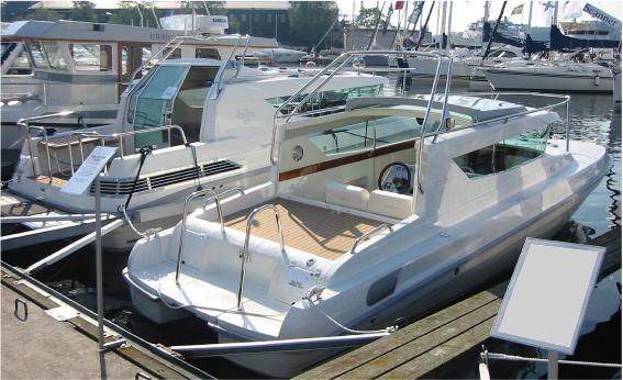

    A picture of the boats from the transom at a recent Boatshow in Stockholm.

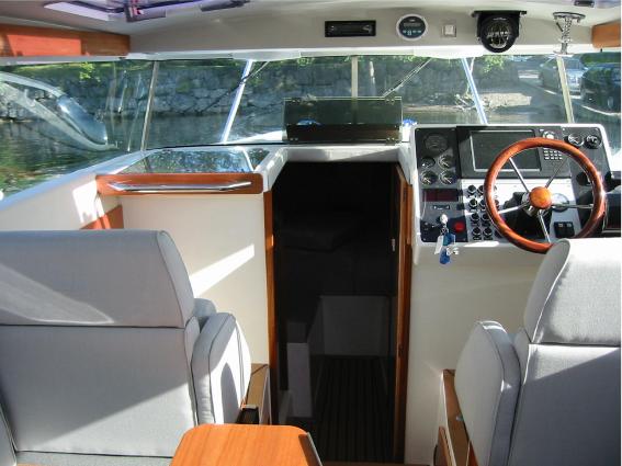

  9. AMG
    5,392

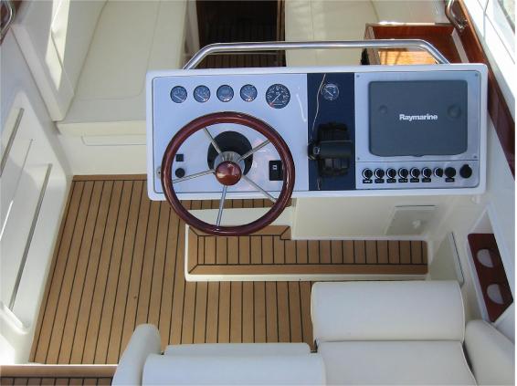

    Interior from D25, helmsmans position with passengers a step down each side forward gives good visibility through the angled glare-free windows.

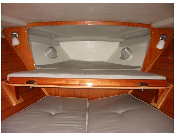

    The 32´forward cabin, with a storage doubling as a childrens bunkbed.

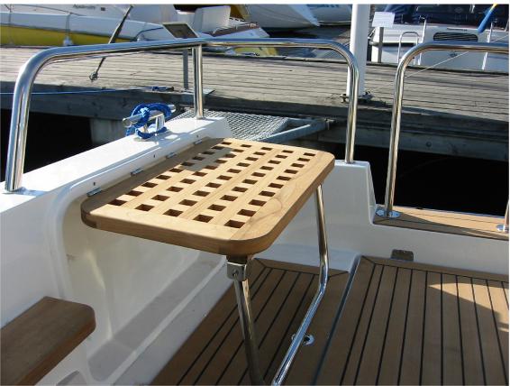

  12. AMG
    5,392
    32´aft deck with recessed foldable teak benchs each side.

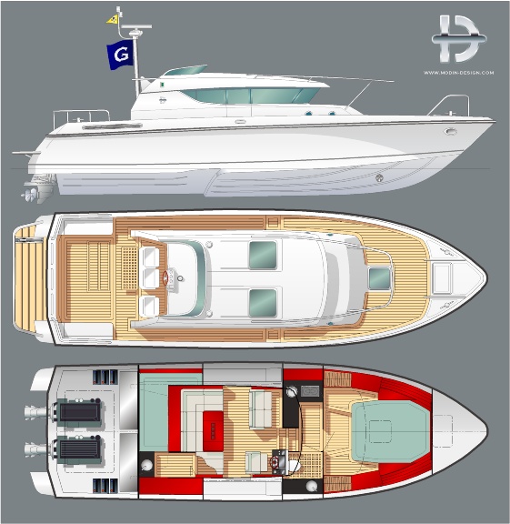

    40-footer to come...!
    As always, some customers are asking for a bigger model and this is the answer, a twin engine 40-footer. Launch date is preliminary fall 2006.

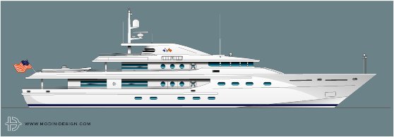

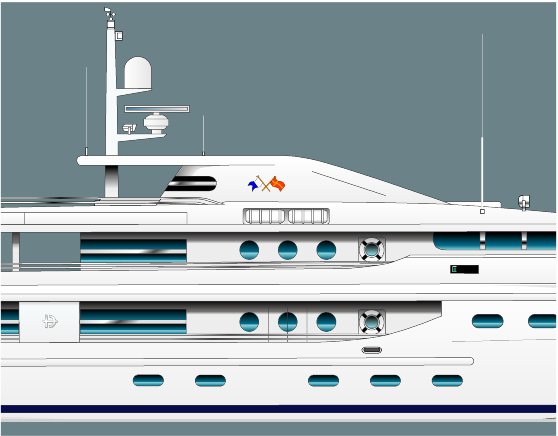

  14. AMG
    5,392

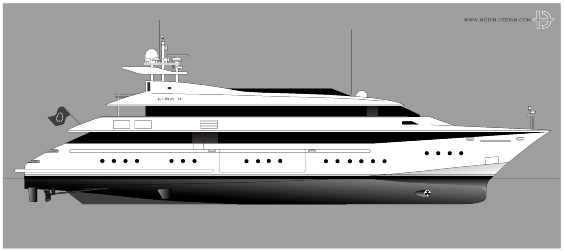

    Get a PDF-file with this 50 m yacht...
    This is a 50 m/163 feet, long range cruiser. The design dates back to 1997-98 and the interior is almost the same as I used in the Chianti yacht you can find here on YachtForums.
    To be able to get a good printout or just to look into the general arrangement plan in a bigger scale, you can get a PDF-file of the whole yacht as an e-mail. If you send me a PM with an e-mail address where you can recieve a file close to 1Mb, I will send it to you. :)

  16. YachtLover
    YachtLover New Member
    Jul 1, 2004
    28
    n/a
    Man, Lars, I love your designs!!! I like those commuter boats. They look alot like a yacht. The 40 footer is nice, too. But my favorite of all your designs is the 25-foot coupe...the one that costs $100,000. How much would the 25 foot commuter be, and the 40 foot commuter?
  17. AMG
    5,392
    Thank you,
    Yes the design is a little like the bridge on a superyacht, and the reason for the forward angled window is the same; To get glarefree views both day and night-time. You also get more headroom and less heat from the sun.
    This 25-footer is USD 80.000 incl a 25% sales tax with a VolvoPenta 270 hp and Duoprop. The 40-footer will probably start at around USD 300.000...

  18. YachtLover
    Jul 1, 2004
    28
    n/a
    Is that last pic the one of the $100,00 25 foot coupe? Is there any interior pictures or ideas of what the 25 foot boat's interior will look like? $300,000 is a great deal for a 40 foot yacht!! Unless you are counting the Silverton 39's Starting price of $269,000...but who would touch a foot in a mass-production yacht, when you can get one with superb quality/design? ;) :p
