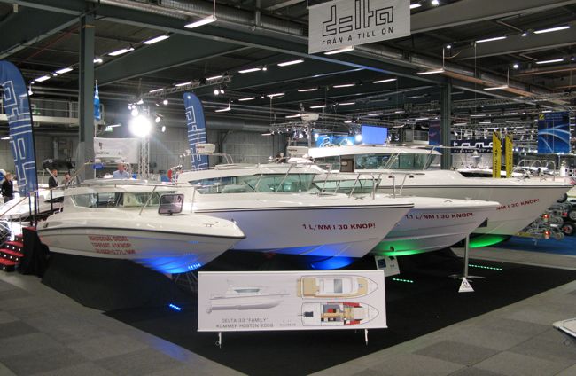

    And Arnie, the show is running this whole week and I think the market here is still good. We are selling what we can produce anyway. As usual we are highlighting our speed versus fuel consumption, more important than ever these days and we have the best figures by far.
    Here is one picture of our four and the coming fifth model. Next after the 33´ may be a 50-footer...:)

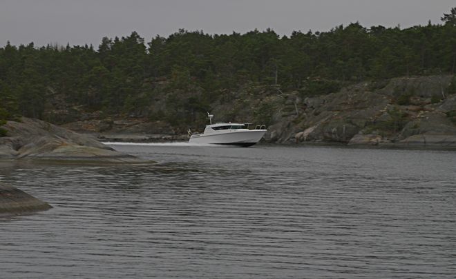

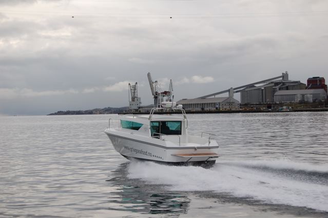

    Today the first D29 client in Norway got his boat. The sea was flat so you can see the minimum wake it produces, not much spray either, just riding on bubbles... I guess the speed is about 40 knots here.
  8. Arniev
    Arniev Senior Member
    Nov 1, 2005
    418
    Monterey, CA, USA
    Wow ... any higher and we have to call it a Hovercraft!
    Very impressive!

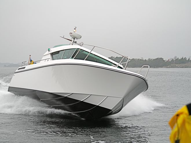

    Thanks for your support! When we first launched this line five years ago, people didn´t really got the idea of this shape of windows on a fast boat. Today we see several boats with similar windscreens being launched. But we are still the leaders in speed vs mileage.
    The 40-footer with twin 370 hp (below) just takes 2 liters per nautical mile at 30 knots... top speed 47 knots, and again, not much wake.

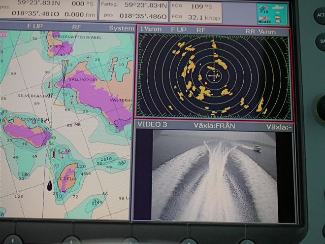

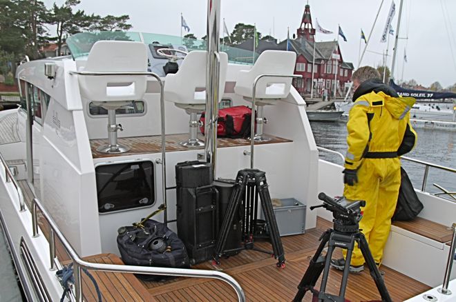

    The picture above of the D40 is from October 27 last year when we were out making a videofilming. Here are a couple of more pictures I took at this trip.
    The first is the nav-screen with aft camera, plotter and radar overlay. Interesting to compare the chart with reality, at least in our waters the difference can be pretty scary if you are running fast...
    Second picture is when we stopped and the camera men asked the other boat to make a sharp turn close to our transom. Which he did, and the third picture shows when we had to dry all the wet cameras...:rolleyes:

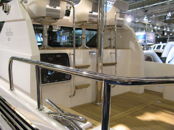

    BTW, we have now changed the design of the aft windows from the salon. Instead of the two small is there now a tinted glass covering the whole surface. Makes the salon more airy and gives a better aft view also for the helmsman. (The pictures are from the recent Gothenburg show).
