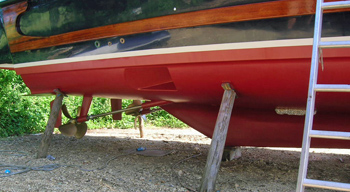

    The semi-displacement boats I used to build had a strong keel, they were based on Pilot Boats and the need to track true is needed when loading a Pilot onboard a ship at sea while moving.
    That said, a SF need to be slippery to move it's ass on to a catch, all on the props and power. It all depends and the use of the boat.
    [​IMG]

  10. Fishtigua
    Fishtigua Senior Member
    Jul 20, 2007
    2,934
    Guernsey/Antigua
    If this system works, look at these samples.
    Just found out how to post a photo, no it's a file now.
