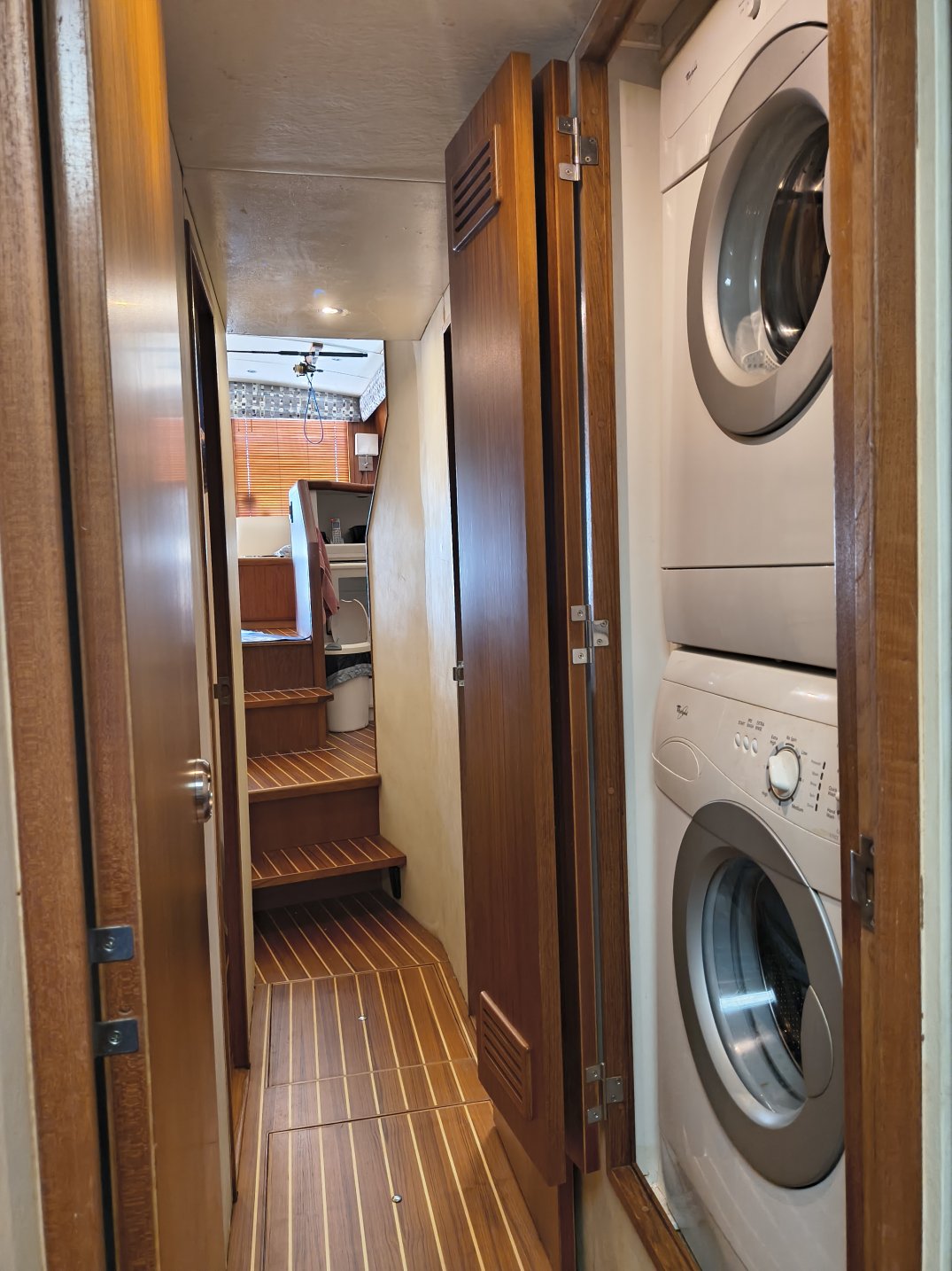

    Hey Gunny, Have you figured where to put a W/D? I have a 72 46.6 and want to travel with her

    I've looked at it but the only way I can think is to eliminate the second head. An apartment sized stack or one of the new dual purpose machines. The only problem i see with the dual purpose machine is that at 125v the damn thing will take forever to dry a load.
