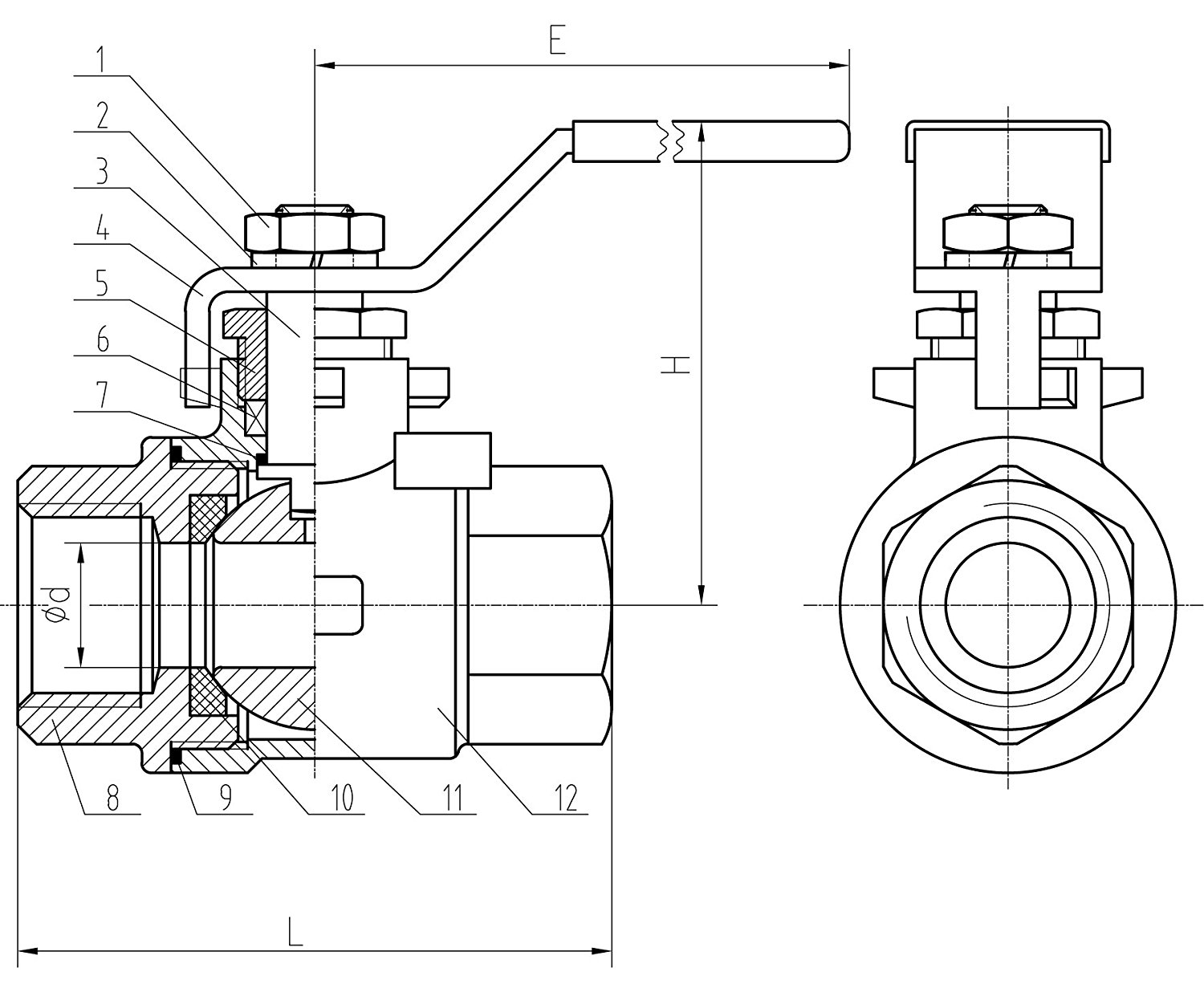

    I don't want to sound negative but I'd be concerned about the weight of that hanging on a few threads in the fairly thin wall of the muffler. On a cruiser style boat you hopefully never will encounter the kind of rough sea conditions I see boats subject to regularly but dropping those out will make a mess not to mention adding a bunch of water in the bilge. I'd want to add a flange similar to a seacock backing to at least get more thread engagement.

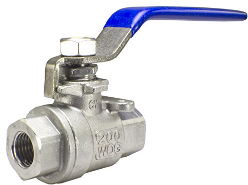

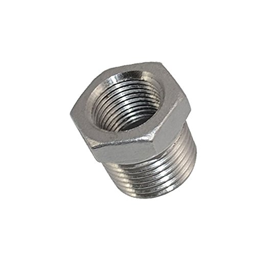

    A few posters have mentioned that, and I agree it is a concern I have to consider. I want the fiberglass guy to add glass to the muffler, and encase the stainless thread adapter threads. That will add structural strength to the muffler walls, which are quite strong in that area, fully encase the thread adapter up to the hex, and give strong internal thread for the valve. The valve weighs 8.3 oz, and at 2.12" long, is more compact than the typical 1/4" ball valve. There won't be a lot of weight cantilevered out on this added lump of fiberglass structure.
