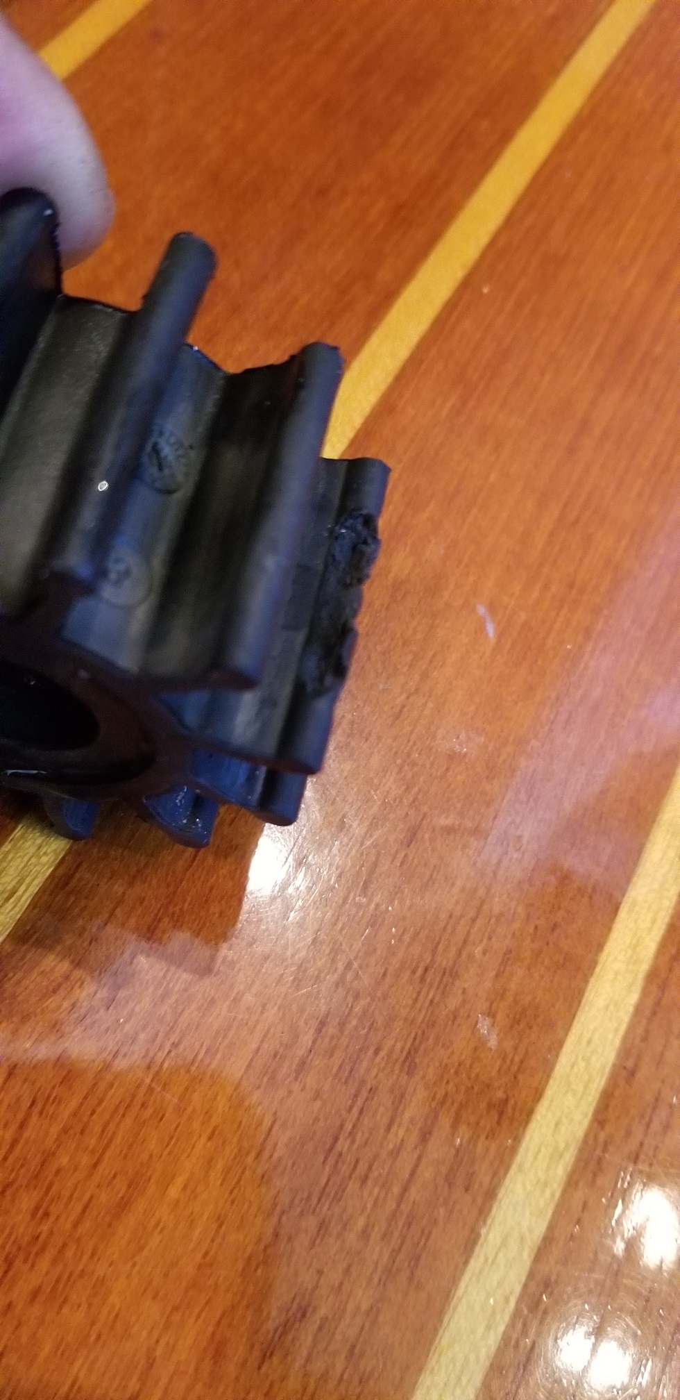

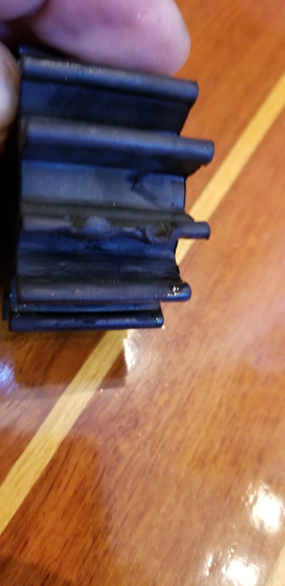

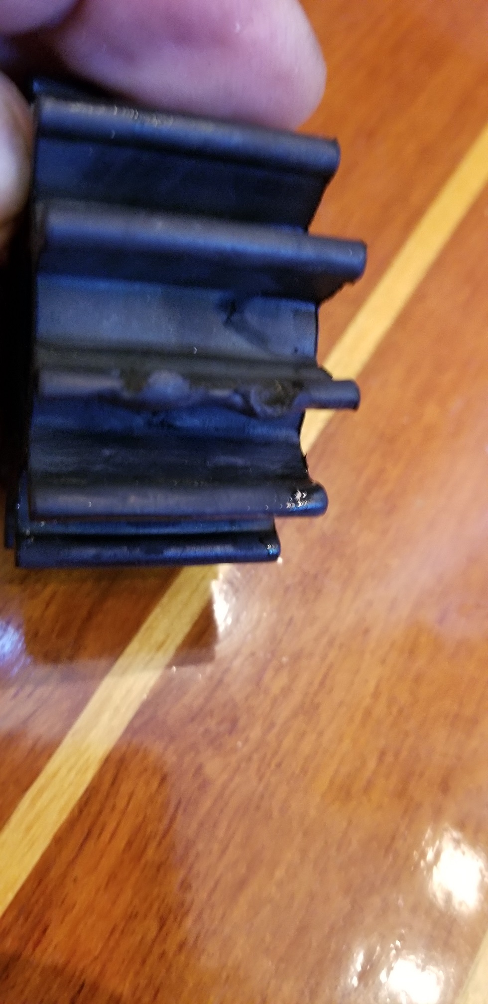

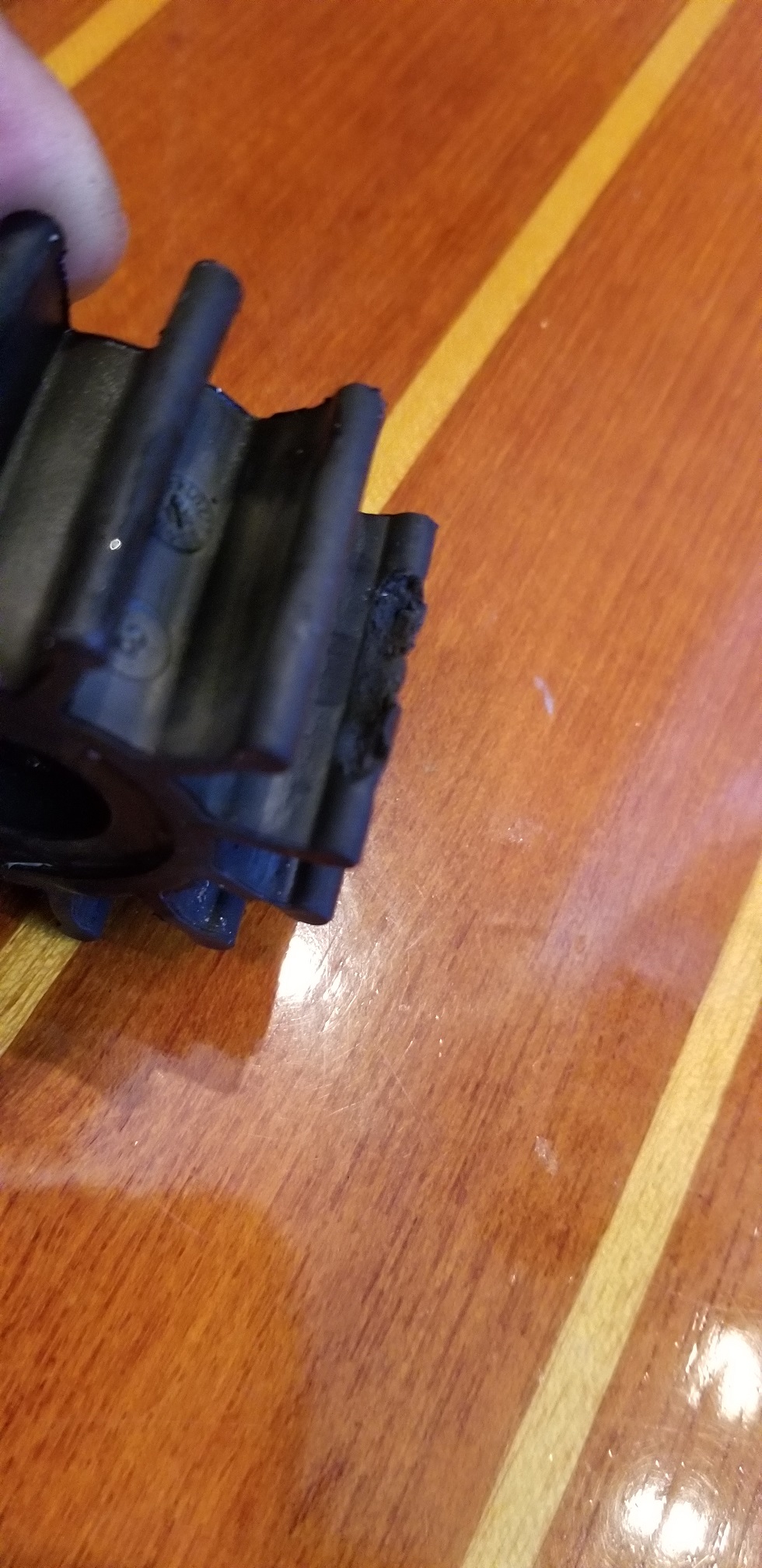

  6. Capt Ralph
    14,591
    150 hours.
    Always check the gen sets yearly.
  7. Beau
    Beau Senior Member
    Jan 15, 2010
    2,261
    Beaufort, NC
    Was there a basket or racor on that intake? that's not age damage in my opinion. Also looks like its on the "lee" of the set?

  12. Capt Ralph
    14,591
    1) was trying to demonstrate an end view does not mean you can see the condition of an impeller.
    2) that is not old age or high hours. Why it's good to check everything before a trip as this customer did.
    Later model NL12.

  14. cleanslate
    cleanslate Senior Member
    May 29, 2018
    1,661
    Cherry Hill, NJ
    I have to say that is an odd rub wear on the impeller , not very uniform...something is gnawing on it seems to me. Don't you think? Anyway I'm still up for a clear end plate! LOL...but as Pascal said , don't think it would stay clear for two long, as the regular bronze end plates get a bit scuffed up on the inside...Capt J, When you stop in Cape May this summer from one of your runs, look me up and you can stop by for my "Change the impellers Party!'' on my boat, assume the position...head down and ankles up! In the bilge. PIA..not easy. Think I need a bigger boat , with a walk around engine room.
  15. Capt Ralph
    14,591
    AND, Just on one blade.

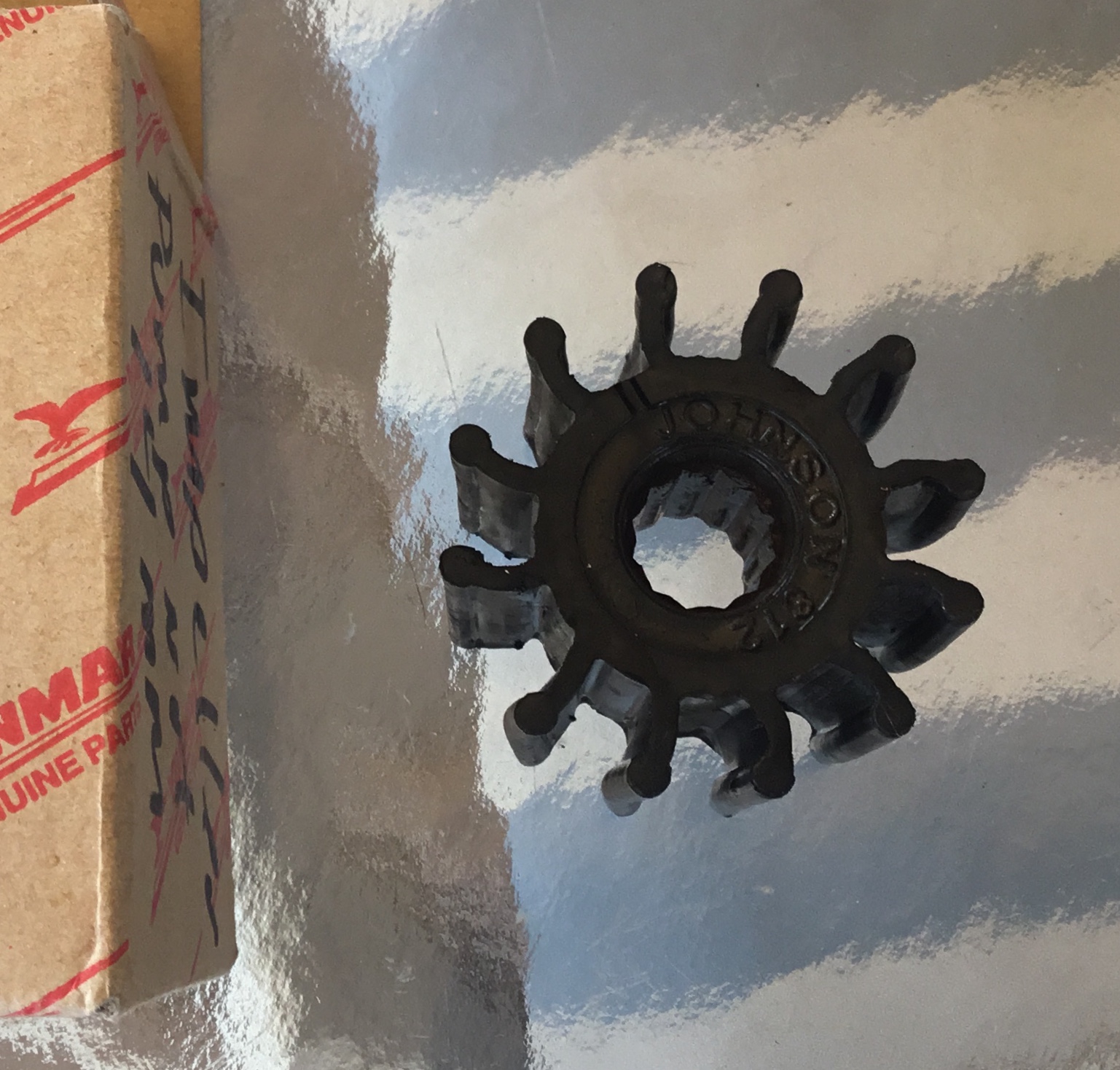

    Timely thread:
    Pulled the water pump today for an impeller change: 2 years and 210 hours in service, looks okay but built up a memory.

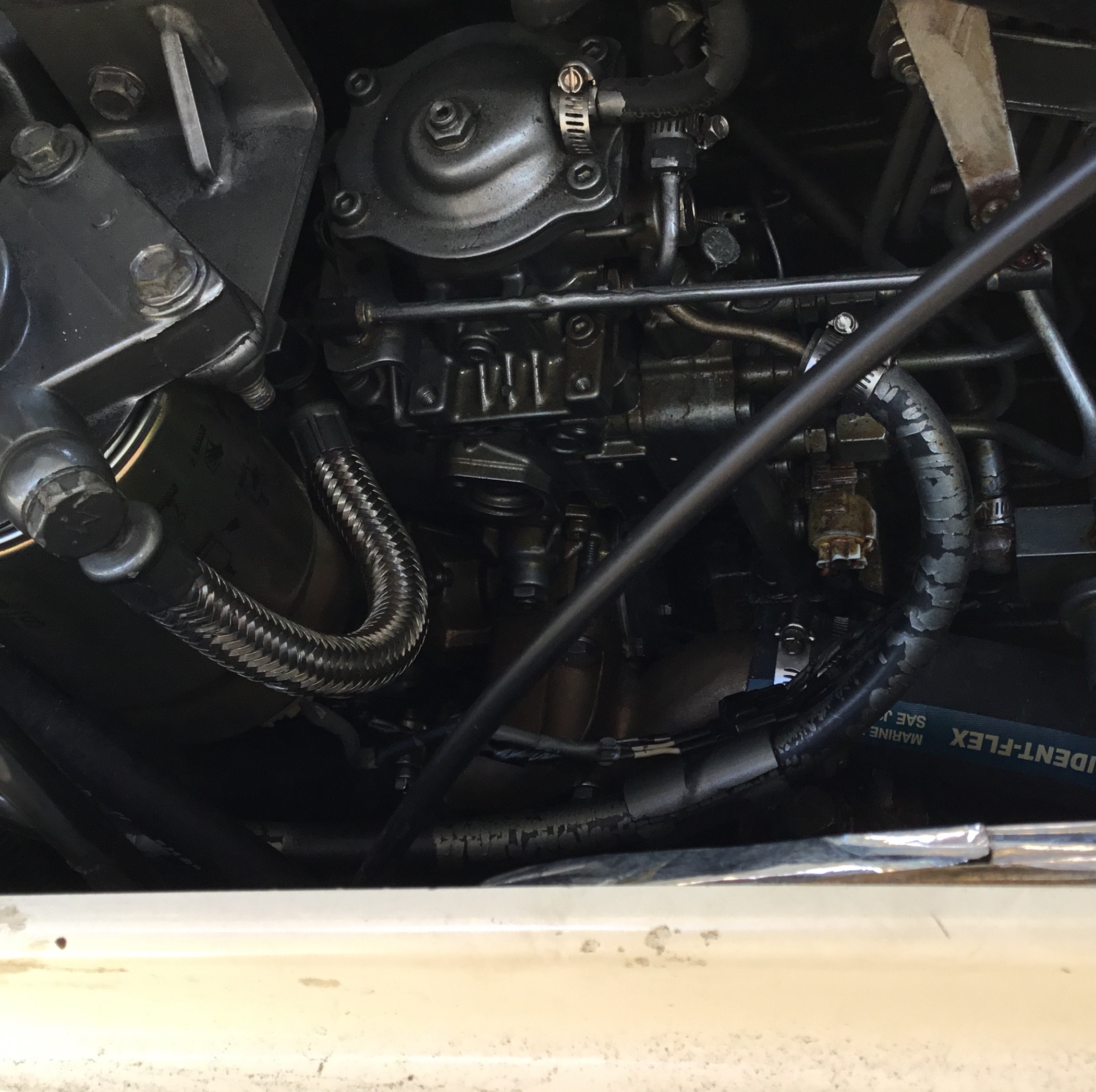

  20. Norseman
    Norseman Senior Member
    Feb 24, 2005
    3,600
    Palm Coast, Florida
    A bottle of rum if you can spot the impeller face plate, AND get the impeller out without removing the water pump:
