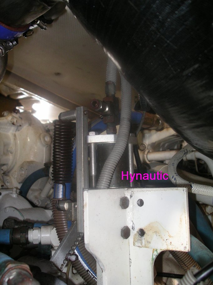

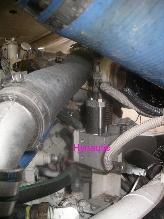

    UPDATE. Will not know 100% until mechanic is all finished but he sounded very confident the problem are some old O rings and dirt in the fluid. Port side one in the actuator on about a 2" piston was sticking and some small ones in the charging valve below the fluid/air tank. Local supply only had one of the size needed for the piston but was available overnight.
    mapism likes this.
