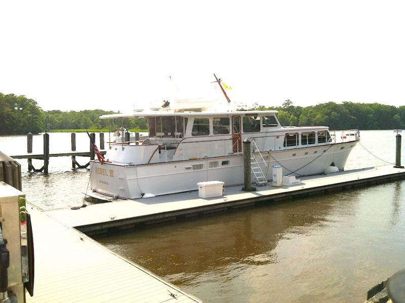

    Rebel vi
    REBEL VI stopped for the night a couple of days ago looking very Bristol. She is a 1966 64.6' Huckins that is being well cared for. A late model 63' Sea Ray pulled in next to her later and the dichotomy was striking.
    Will the Huckins of this world still be that good looking 46 years on or will we consider the Sea Ray to be a classic? :rolleyes:

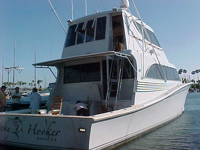

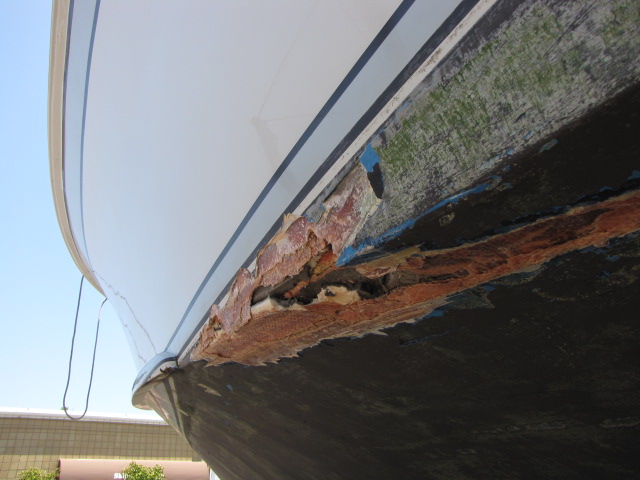

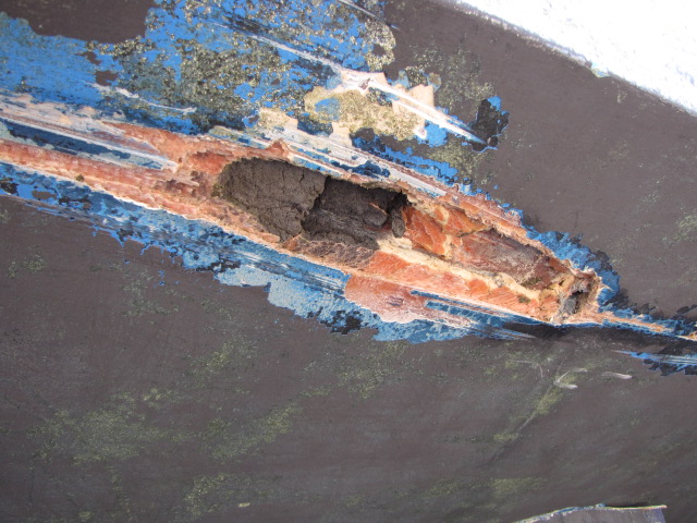

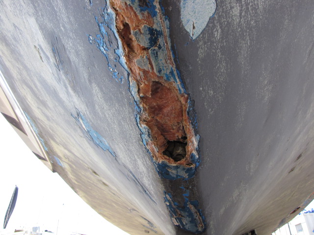

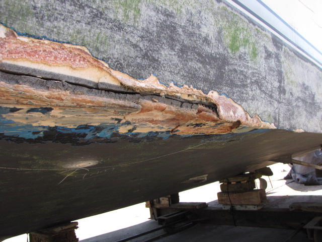

    I was looking at a 1989 70 Foot Huckins sportfisher Lucky Hooker, formerly the Clam Digger offered by Long Beach Yacht sales. Boat was in rough condition with surveyor 3 page list of recommended repairs. Still at 200K with recent repower to Cat C30s not a bad buy. I knew I was going to drop another 200K to bring it up to Yacht Quality.
    Issue with sea trail led to do futher investiagtion, bad vibraton had us look into bilges to find several stringers cracked and hull moving up and down.
    Bank Never Disclosed
    Found out from another source that boat had hit reef off Mexico some 700 miles south and the captian and run the boat to Long Beach before fixing. It apears Bank of America did cosmetic fixes to exterior but did not address the cracked stringers mid ship and near both struts.
    Boat yard said damage to hull core might be extensive due to vibration running boat for so many miles. They also spotted cancer above the water line.
