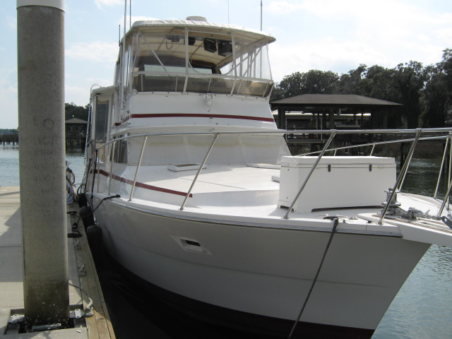

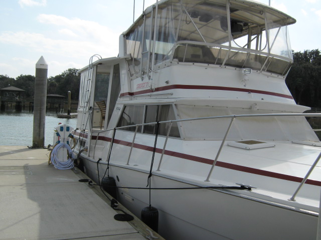

    BTW - I closed on a 1980 Viking DC a month ago. 6-71N's with 480 hours, updated thoroughly including electronics. Going to move aboard in Savannah next week.
