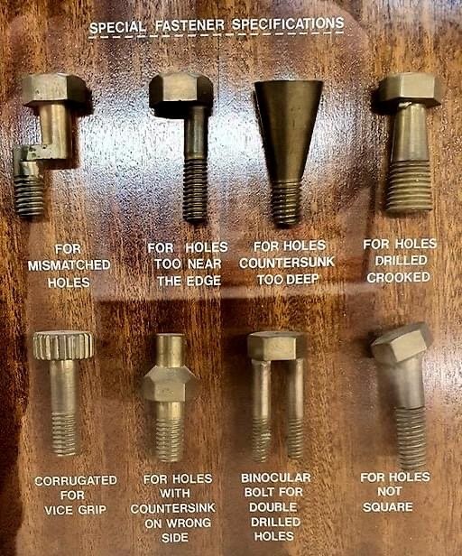

    We lived on the Huckins dock for over 10 years. Observed their techniques often.
    I worked on many of their older boats.
    Theses and more are common hardware answers to their trade.
    Huckins just sold and I wonder if these practices will remain a trademark or,,,, modern straight drill holes will be finally achieved.
