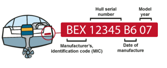

    As a quick refresher, here is what the entire HIN number represents, usually in the upper STBD side of the transom:

    I believe the last 2 digits refers to the year the hull was laid or when the number was assigned to the vessel.
    With larger boats it is quite possible to have the year on the hull number conflict with the year the boat was actually sold.
    Also, I think the letter and number before the year refer to the month the HIN was assigned.
