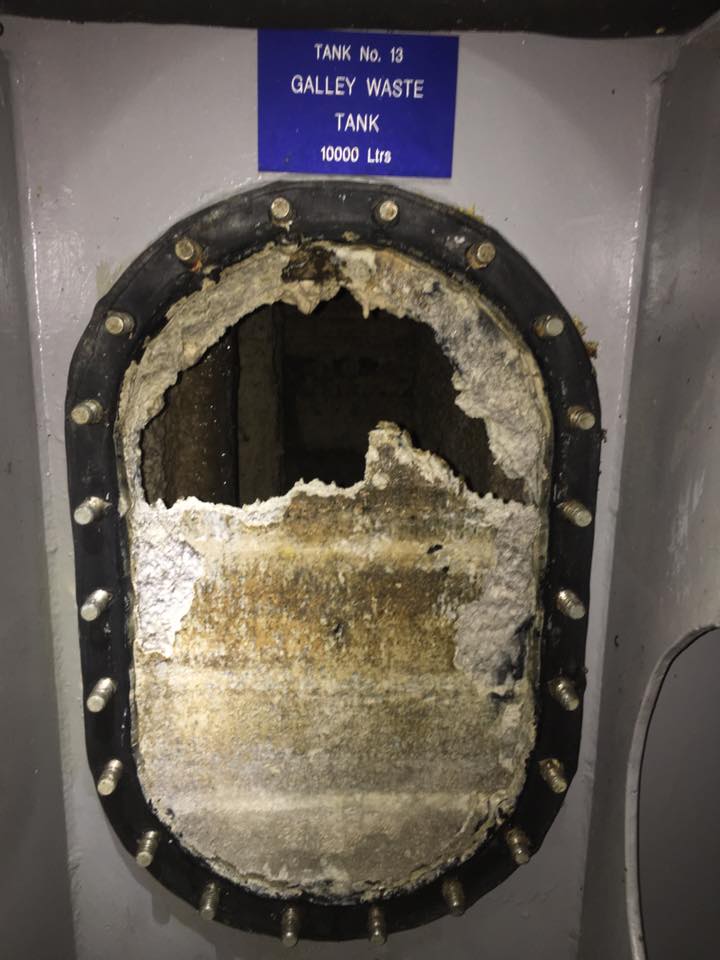

    The Canadian Navy is using Noflex on a couple of ship's to stop and clean the buildup in the galley waste lines.
    sail boaters are using a little in the low parts of their keels to get rid of the stagnant bilge

    We used to be able to use just about anything to deal with that but these days with biological sewage plants that need to use grey water to make up their liquid load we have a separate fat trap and can't use any chemicals that will affect the microbial action in the STP.
    The photo is not on my current boat.

    In the Noflex case it's used before a F.A.S.T. MSD biological system
    They still have to clean the trap but just Noflex is used it for pipes from the galley. It enhances the biological system only a little most of the product is spent before hitting the tank .There are more FAST systems using an auto dosing machine to ad Noflex directly into the media tanks to remove the sludge with little or no effect on the bacterial growth usually enhancing it
