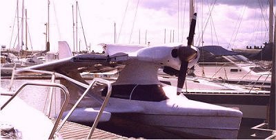

    orion Senior Member
    Feb 19, 2005
    399
    Newport Beach, CA, USA
  10. tartanski
    tartanski Member
    Nov 5, 2004
    116
    Hamburg, Dunnon, Buzios
    Amazing
    The Centaur is really great , combines WIG effect and new hull design, about time someone did this.
    And to topit all off it is designed with CATIA too. :)

    Orion, thanks for the link. the plane looks like it would have a lot to offer a Yacht. It is light to be carried on the Yacht and lifted by Crain, but the wings fold :D inside the beam, it might be posible to have the plane float into a garage. What do the rest of you think on that? ;)
  12. YachtForums
    20,954
    The Centaur option looks pretty good. Keep in mind... you can't set it down in rough water, well... maybe you could, but it might leave the reproductive capabilities of your significant other in a somewhat questionable state. :D
    Other things to consider... loading and unloading next to the ship could get dicey in certain conditions. In addition, unless the wings are swept back into the TomCat position, passengers might be doing backstroke to get onboard the ship. Also, the ship will need to be stationary to "pluck it" out of the water, unlike a heli that can approach a ship underway (the civilian version of a carrier landing?)

    Seaplane docking
    Ok, rough water could be a problem:confused:
    Picture shows a nice way to park the plane, a floating dock behind of yacht.;)
    There could be a "hangar" in aft so it easiely be winched indoor.:rolleyes:
