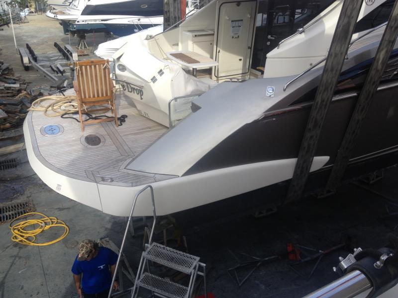

    I might be missing something (wouldn't be the first time), but if you are along side, why wouldn't you step on to the swim platform of a floating dock or on over if fixed? I haven't seen a Sunseeker without gates, maybe you couldn't see one in the railing. There was one like this here just the other day.
  2. Pascal
    8,948
    Nope, no gates whatsoever, no opening, no boarding from the side. I looked!
    From a fixed dock it s too high a drop... You need a 3 to 4 stepper on the platform.
    At least on the Sunseeker the platform extends close enough to the dock to put steps there but on the Mutts you can't because of the taper. But even then, it would have been so easy to have a step where the cleat is

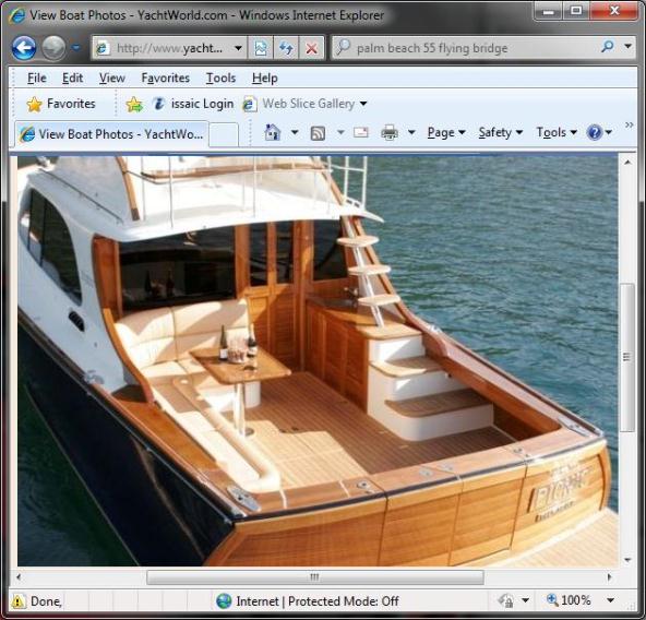

  6. carelm
    carelm Senior Member
    Feb 5, 2011
    403
    fairfax va
    I think the Palm Beach yachts are beautiful vessels, but the FB50 is an accident waiting to happen. Check out the access to the bridge. No handrails or protection of any kind. If you're underway and you hit a wave while someone is trying to either go up or down, they'll either go kersplat on the cockpit or kerplunk into the water.

  9. carelm
    Feb 5, 2011
    403
    fairfax va
    Palm Beach probably has an option for it already, but why be cheap about it when you're buying a $2M-$3M boat? It's likely the price of a proper handrail(s) is only a grand or two.

  11. K1W1
    7,453
    It probably isn't as bad as it looks.
    If you look at the house height you will no doubt be able to use the steps like a ladder - do you have handrails on ladders?

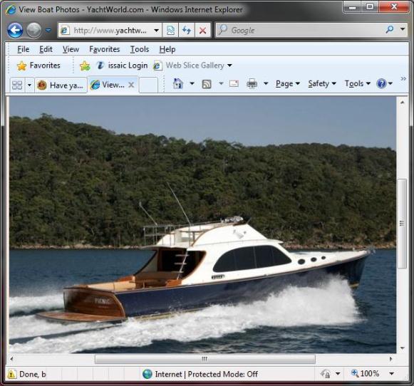

  12. carelm
    Feb 5, 2011
    403
    fairfax va
    Maybe so. I'm not as young as I used to be and I break easier now. I just looked at the distinct possibility of taking a header either going up or down the steps.
    Here's a running shot and my first thought was " if it that was safe, how come the pilot isn't enjoying the view from the bridge"?:D

  17. rgsuspsa
    rgsuspsa Member
    Apr 11, 2009
    87
    Melbourne, FL
    Does a house ladder pitch, roll, yaw, heave, accelerate and decelerate?
    Not only is the bridge access as bad as it looks,
    when used for its ostensible purpose the ladder places its user in substantial danger of grievous injury, or death.

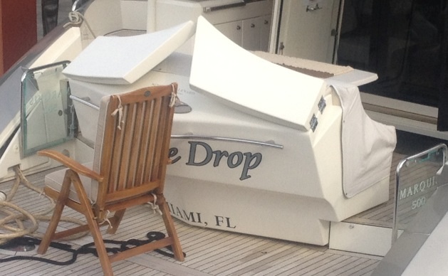

  19. Pascal
    8,948
    Yet another one... 3 feet of bulging fiberglass unprotected from pilings on this marquis 50
    Then we have a pair of big transom doors folding upward. Imagine the pressure on the hinge if someone lean on them from the transom...
