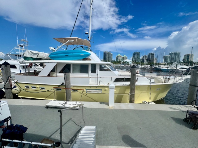

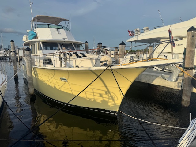

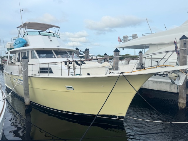

    It s been a while since I ve updated this thread. When I started the project about 8 years ago, I thought it would take me 3 or 4 years. And no, it s still not finished.
    in addition to a bunch of small projects, paint has been the big one. Over the last year or two I ve painted most of the topside and have recently been working on the hull which has accumulated a bunch of scars over the years, especially during Irma, as well numerous paint and gel coat cracking which required a lot of fairing
    just finished putting on the first coat on the hull and hoping to do a second coat this week end.
    I decided to modernize the looks a little and went with a Fighting Lady Yellow hull (slightly toned down with 30% white) and Snow White for the superstructure.
    i m using Alexseal with the rolling additive. No tipping needed.
