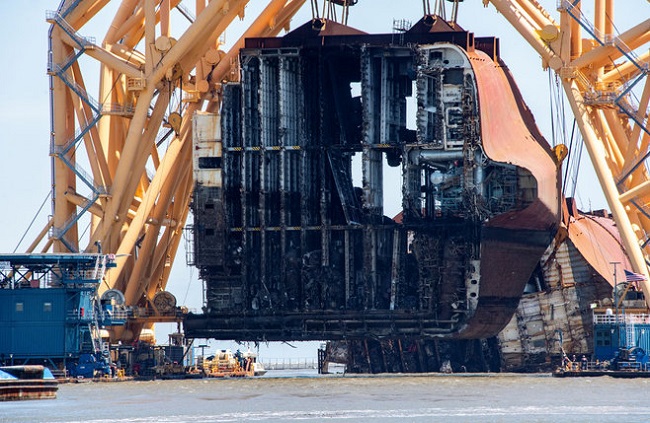

  19. Capt Ralph
    14,574
    Section 7 is up. I was expecting to see some big engine parts.
    What did I miss?
  20. LM Viking
    LM Viking Member
    Sep 20, 2018
    163
    Michigan
    Wonder what the other end of cut 7 looks like since that was where the difficult cut was from section 6.
