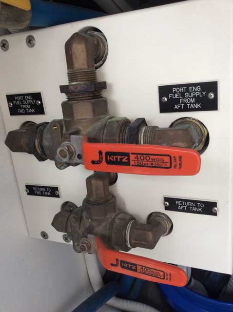

    That shows you drawing from and returning to the forward tank only. Pull those handles down and you should be using the aft tank. With that boat I wouldn't recommend running off the aft tank only though until you've drawn down the forward tank. There may be a position that will allow you to draw off both tanks at the same time, but it's not indicated. It also doesn't appear that you have the capability to run each motor off a different tank.
    Always make sure that both handles point in the same direction or you'll be returning the fuel to the full tank.
    You may have a fuel tranfer system some place else. Look for it. If not you stand the risk of doing all your running off the forward tank, leaving the fuel in the aft tank to go stale.

    Looks like you pull them down to draw from the aft tank. There is a little flow arrow on the orange handles?? When that change is made it looks like the port engine runs off the aft, and star remains on the forward. So each engine will be pulling from a different tank. Right now I think both engines draw from the forward. Which tank feeds your genny?

    This set up is typical for Posts. I'd be surprised if he has the reversed setup on what looks like it would be the port side? Genset generally draws from the smaller tank to maintain a reserve. Be interested to see what the OP posts?

    Ok, you just turn both handles (the supply and the return) 180 degrees and you'll be sucking off of the aft tank. Opposite from the handle is where you are drawing from. A lot of modern SF do like to run with the bow tank emptied first, but you may have to experiment with it and see how the running angle is. Another option is to run 1 engine off of the foward and the other engine off of the aft. The valves in the picture are for the Port engine only. Make sure the supply AND the return are pointing to the same tank (same direction).
    I am sure there is another set of valves for the stbd engine. The genset may only run off of 1 tank since they use so little fuel anyways.

    I think the valves handles move 90 degrees to straight down?
  9. Capt J
    14,904
    No they're a 3 way valve, in the middle is off......even though they aren't labeled as such.

    You all are great. I'll look for second set of valves in the morning. I'd prefer each engine would run off its own tank and not transfer fuel if possible. Unless there is something wrong in doing that. Let's say you have to run off one tank at a time , can you switch vales while your running. Yesterday I left Key West in big seas, waves coming over top of boat. Be tough getting down below
  11. Capt J
    14,904
    You could switch them while underway. How does the boat run as you drain the foward tank down? Most faster SF like to run with the foward tank drained first and some trim tabs to give the stern lift.....but if you get too far, it'll run bow high.......Does the boat have a fuel transfer pump as well?

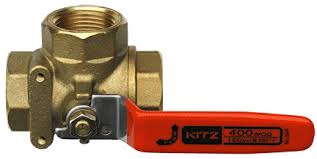

    Look at the handles of these valves, there is a very clearly marked flow path, there is also what looks like a stub sticking out that would prevent the turning 180 deg and subsequent closing of the valve removing the fuel supply to the engine which if done underway could have some serious consequences.
    A 3 way valve is exactly that, it will have one port open in either position and the other one can be in either of two positions as long as the handles are moved 90 degs between positions.
    Beau who originally said to move them down (90 degs) to change the suction and return tanks in service was absolutely correct.
    This is what I am sure the valves look like from a different angle.
