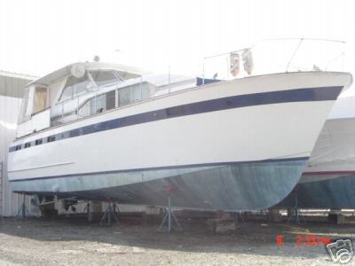

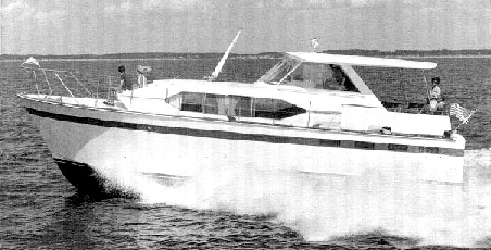

    The juxtaposition of these two shots just about makes me want to cry. :p

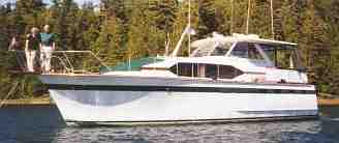

    Stripes we've seen
    All lined up and ready to go (painting).
    Fact of the matter is, you want to:
    (1) Gradually get wider towards the bow - so as to;
    (2) "Capture" (and hide) the porthole windows, and;
    (3) Don't allow the flair of the bow to cause the top line to dip or rise - stay straight.
    Well, thatz our story, and we're sticking to it.
