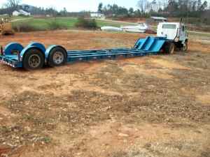

    Taking chances on an internet purchase sometimes you didnt get what you wanted but a new opportunity opens up. The rig set up is real sweet. Ill post some more pics later. There are a lot of boat hauling opportunites here on the west cost that I will recover my investment back with this setup.
    The story - I bought trailer from dealer in Atlanta, got a good deal and trailer is basically brand new. What I didnt know, being a big boat neophyte and have since found out is a 37' Roamer is not 37' long its 37' at the water line. Thus the rear end and all that weight sticks 3-4' foot beyond this trailer. For Roamers this trailer is better suited to the 27'-32' models and not best for inboards overall w/o some modification. The trick setup is the con-o-lift or hostar type hydrualic trailers but they are big bucks.
    Attached is the new trailer which I will have to hoist load but gets the main plan back on track and more of a business opportunity. Overall I have learned this a bit bigger boat than I really wanted so I might be looking to find a buyer for the 37 and get a smaller 32' Roamer or Marinette

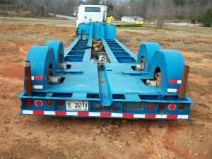

    Here are pics of the new low boy. Also from Atlanta and even cheaper than the aluminum.
    Anyone needing hualing I would be glad to help Roamer forum members out for basically expenses and time.
