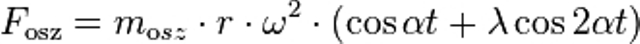

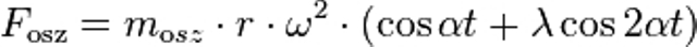

    Great find KARO ! But opposite engines, 180 degree v-engines and radial egines are even more difficult.
    And OB I agree, the normal owner/operator of a privately used pleasure boat does not need to know all that mathematics but from a professional marine chief engineer you can and have to expect such knowledge.
    Equation of mass forces

    I agree. I dealt with such equations long ago as a college freshman and by my sophomore year had forgotten them all.
    Fortunately, while engineers can certainly add to the information the OP is seeking, one doesn't necessarily have to be an engineer to answer his question.

    You can pass your Chiefs orals even if you can't quote every single formula known to man kind as long as you can tell the examiner where you can find that information.

    KIWI, the formula was more or less added as a little joke. Explaining the basic disadvantages of a V10 engine, I was trying to say, that a professional chief engineer (not me anymore) would be able to prove that by means of his professional knowledge ;).
