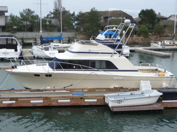

    Photo from YachtWorld
    Boat is much smaller than I thought with a much smaller flybridge. Where did they put everyone?

    I think that pic is of an old 31 Silverton.
    The 34 that was involved in this incident was a little bigger, but not much.

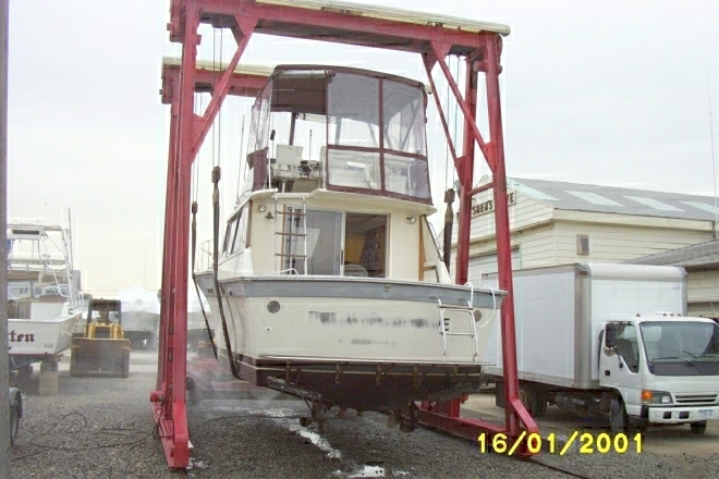

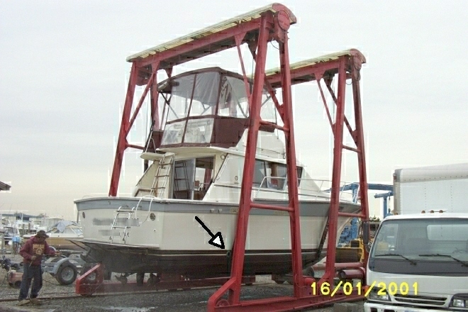

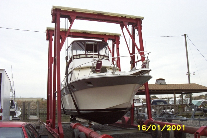

    Let's look at some details. The 1987 34 Silverton pictured here is the same model/style as the one that sunk, which was 1984. The draft is approx. 3.5 feet, shallow but not bad for this vessel. See the scuppers in the transom? That's the cockpit height, well above the waterline. Salon floor is at same level. There's a lot of boat above the waterline. I almost had this boat capsize in a squall, so much that the boat heeled over where the water level was almost to the top of the gunwale, but she did roll back (only 4 persons on board).
    The bridge seats 5-6, but you can get 8-9 up top if required.
    Second photo shows a nice entry with two strakes and generous chine.
    Third photo shows that there is very little keel in the hull. Also the arrow shows the exhaust port which is just above the waterline. With 27 persons on board, the port and starboard exhaust will be underwater as the boat will ride low. Perhaps back pressure created a water leak in the exhaust system?
    But let me ask our resident hydro engineer this: a boat that sits low in the water and traveling over shallow depth could actually get pulled down due to hydro forces, can't it? At least the speed will be reduced until the boat crabs into deeper water.
    Having 27 persons on board had to be very cramped, with a lot of weight well above the waterline. And the aluminum radar arch on that yacht adds a few pounds.
    Just trying to illustrate.
