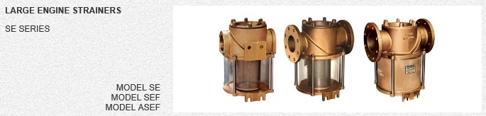

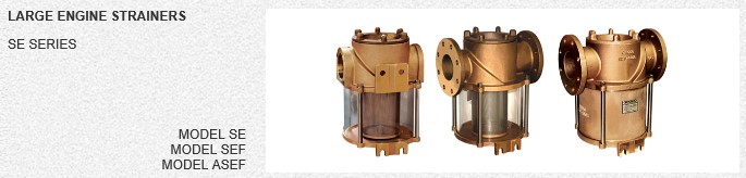

    What kind of inline (interior) strainers do you mean Ralph?
  3. Capt Ralph
    14,578
    Large vertical Groco's in the surveyors question.
  4. P46-Curaçao
    P46-Curaçao Senior Member
    Mar 8, 2013
    734
    They must be large, like these?
  5. Capt Ralph
    14,578
    I was thinking more towards the SA series is what the surveyor was leaning towards for the redundant strainer.
    What are your thoughts?
  6. P46-Curaçao
    Mar 8, 2013
    734
    Haven't measured it jet, but it looks like at least 6" diameter, so the SA series won't fit, and pay $6K each, sounds way out of perspective...
