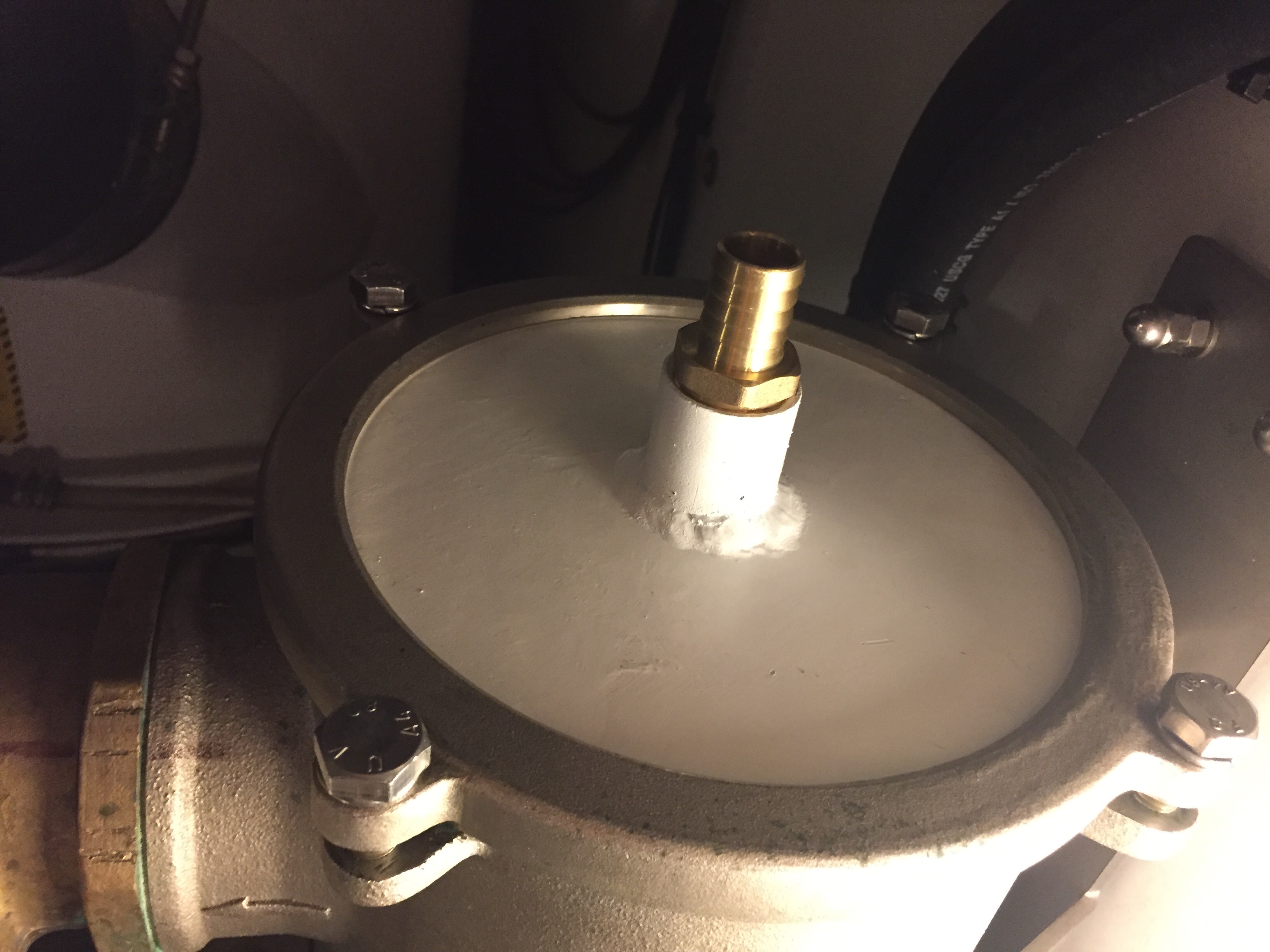

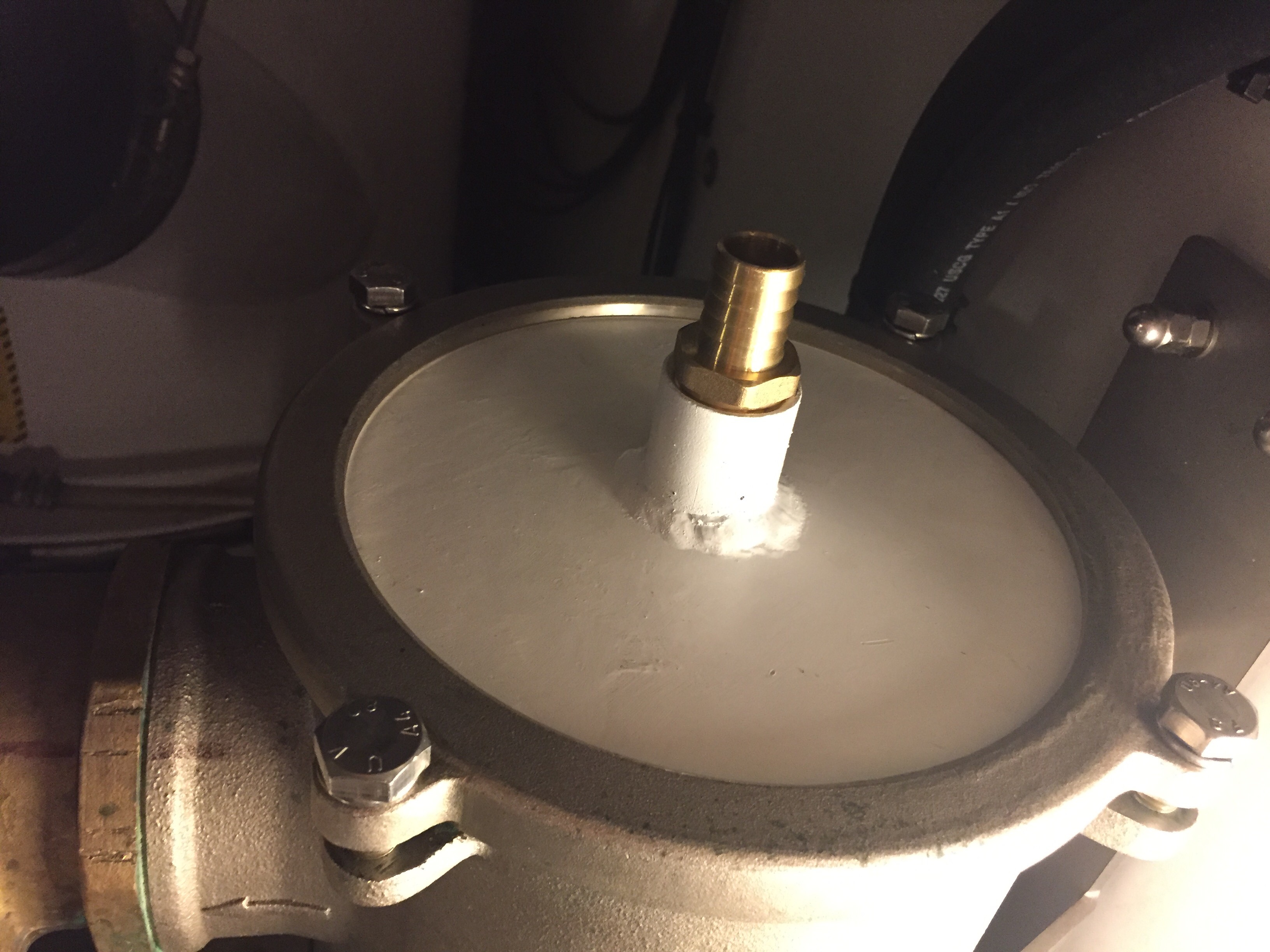

    Hello,
    Do you have any information about where that cap on the Guidi strainer with the threaded fitting came from?
    I do not believe it is a standard part from available from Guidi or Princess., and although Seaboard Marine sells flush caps like that for Groco strainers, I have not seen anything like that available for Guidi strainers. I would like to make a similar arrangement on my Princess 56, which has the same 3" Guidi strainer as shown in the photo, and I'm trying to determine the best way to obtain or make a cap with a fitting like that. I'm currently thinking of buying replacmenet metal caps from Guidi and having them drilled and tapped by a machine shop to accept a threaded fitting.
    Thanks for any information you have.
