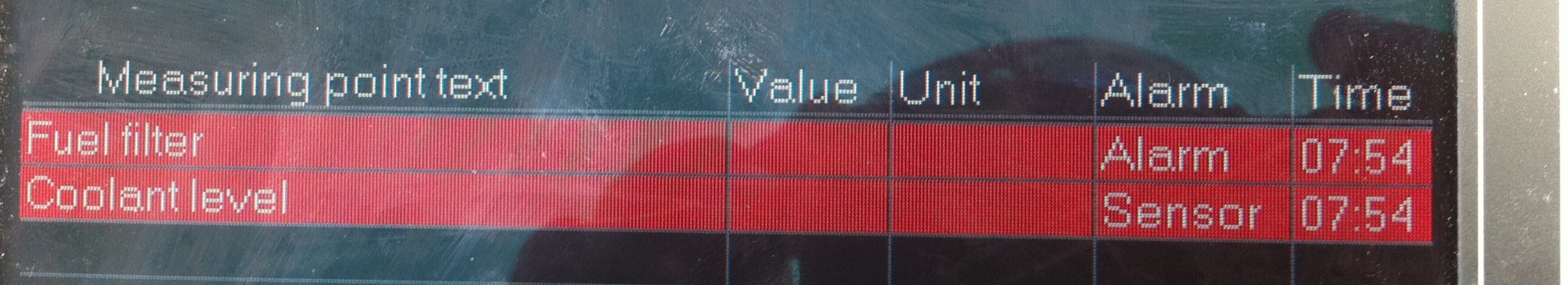

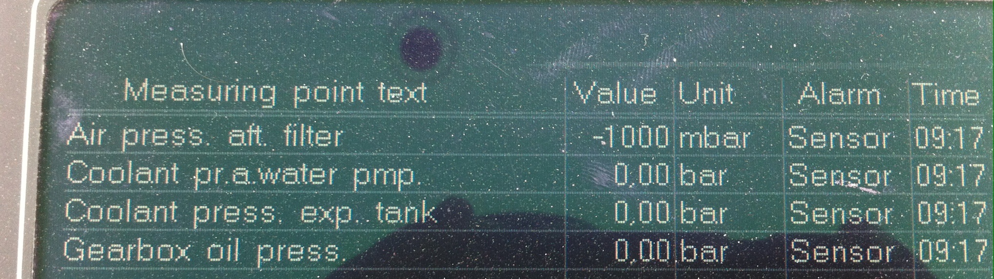

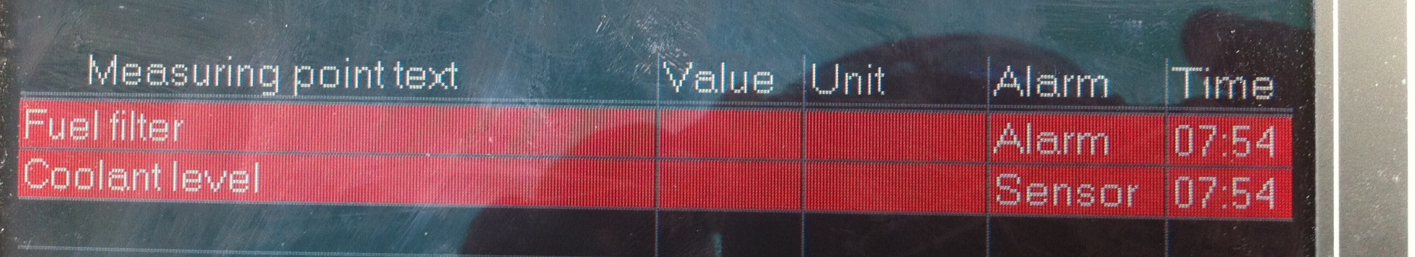

  12. Nicol
    Nicol New Member
    Oct 18, 2015
    32
    Seychelles
  13. Capt Ralph
    14,567
    Damaged wire lead or connect at the sensor.
    The wires are pretty thin. the connects are not forgiving to abuse.
    MAN boards have some problems but not for to many sensor issues.
    What does the error say? Sensor not found? out of tolerance? or bad sensor?

  15. Nicol
    Nicol New Member
    Oct 18, 2015
    32
    Seychelles
    ii seems sensor not found because I swapped it and it still say sensor

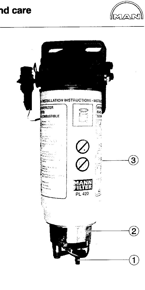

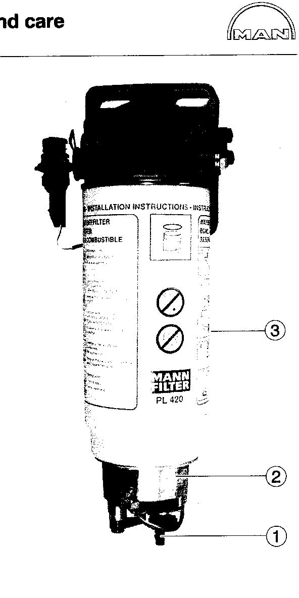

    No it hasn't got wet .do you have a picture of the WIF filter
  18. Capt Ralph
    14,567
    It's not a WIF filter, just a big spin on fuel filter with a spin on clear base bowel. Usually mounted Between turbos over the flywheel housing. The WIF sensor (water in filter) is installed in this bottom bowel. The wire leads hang down from there. The WIF wire leads get in the way when you service the raw water pump. AND will get twisted when servicing the filter.

  19. Nicol
    Nicol New Member
    Oct 18, 2015
    32
    Seychelles
    Ok I saw that filter and yes they the wire was
    touching together and making shorts so I separated them apart and the fuel filter alarm went off so now the coolant sensor is still there I checked the level and it full and also it's a new sensor why is it saying something is wrong with it .Also there is no man Tec in seychelles I have to try and figure out myself
  20. K1W1
    7,453
    If you are getting WIF Alarms and the clear bowl is clean and no water in it another cause can be any additives and or biocides in the fuel. Some of these make the fuel conductive.
