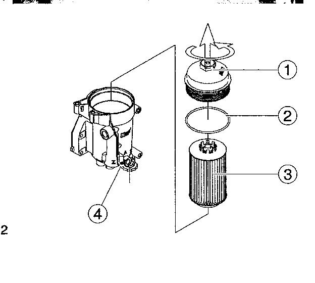

    Item #1 is the black plastic cap.

  16. Capt Ralph
    14,570
    If your sure there are no other leaks, turn your tanks off, remove the tops again. Inspect for cracks around the hex pattern on the top and nicks in the O ring. If all looks good, grease up a fresh O ring and reassemble.
    Your not looking for tight, but ensure the cap is all the way on; lip of cap down to filter case body.
    Over torquing may cause a crack between the course threads to the lip of the cap.
    The O ring makes the seal, not the cap lip. When the cap lip is just down to the filter case, the O ring is in place.
