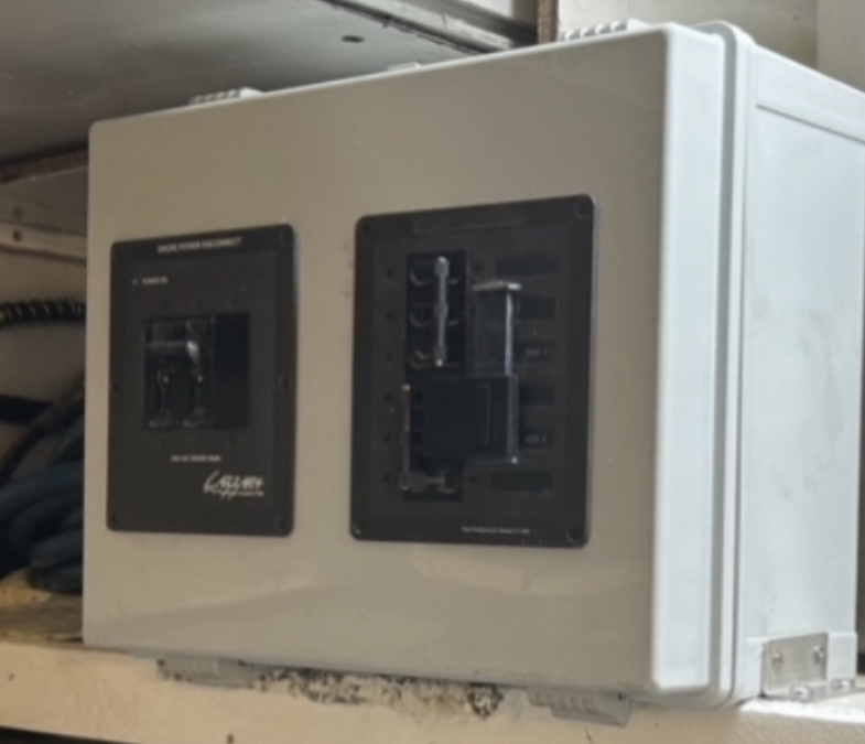

    Quick update on this. Rewired the emergency generator as a secondary generator. Simply relocated the existing transfer switch and upgraded the breakers in it accordingly. New location is in a new box that shares the main breaker. Just over a year now and I couldn’t be happier. Turns out the 13k is a great choice for cruising
