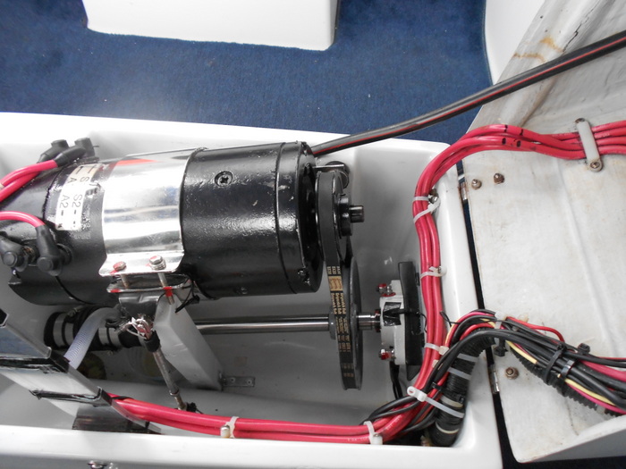

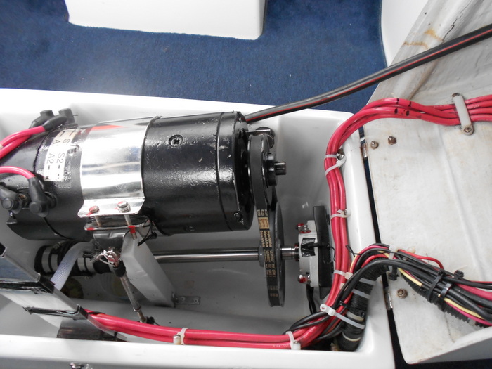

    Norseman....I did it ! The black thing on the bearing is a heat probe. The wood block is just in case the metal support were ever to give way the motor would not smash into the dripless water connection.You'll notice a shim behind the rubber bearing block, that is so things aligned up correctly. When I installed this new bearing I did not know that the bearing would pivot in the housing for good alignment.

    I took the Duffy out for one hour at a constant 80% throttle ( 5 m.p.h. ) and with a infrared thermometer recorded the bearing temperature. It toped out at 140.9 degrees and then came down to 135.6. At 140.9 degrees you can touch it for 7 seconds before you burn your finger. At a nice middle throttle position ( 3 m.p.h. ) in went to 117 degrees in 20 min.
    The old, but reworked, motor reached a max. temperature of 151 degrees.
    Any thoughts if my bearing is getting too hot ?
