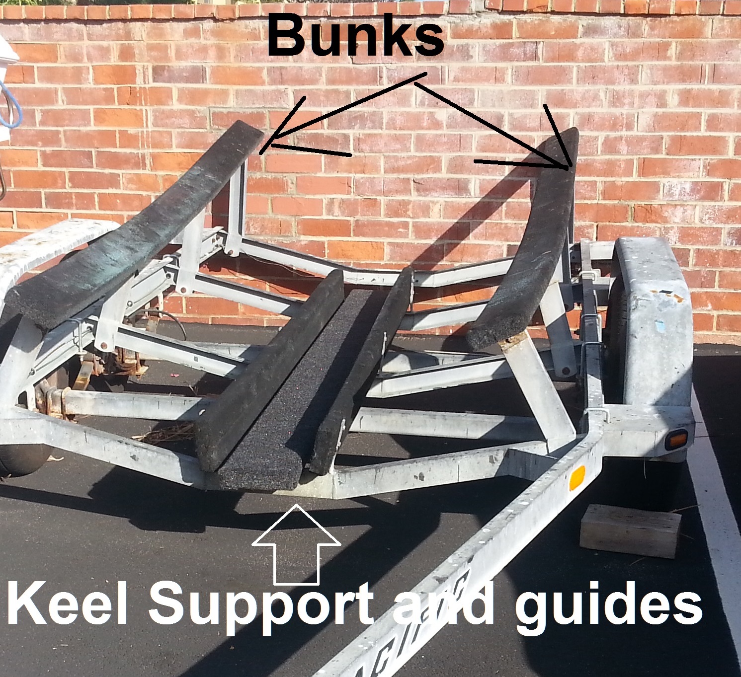

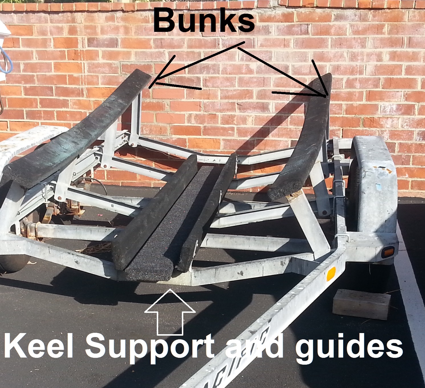

    If you are going to go a distance, you should have a trailer that will allow the Duffy to sit on its keel rather than the hull alone. That is how the Duffy trailers are designed. The boat sits on the keel and the rails are just to keep the boat upright
    The Hull ID Number is normally on the starboard side of the stern, just under the rub rail.

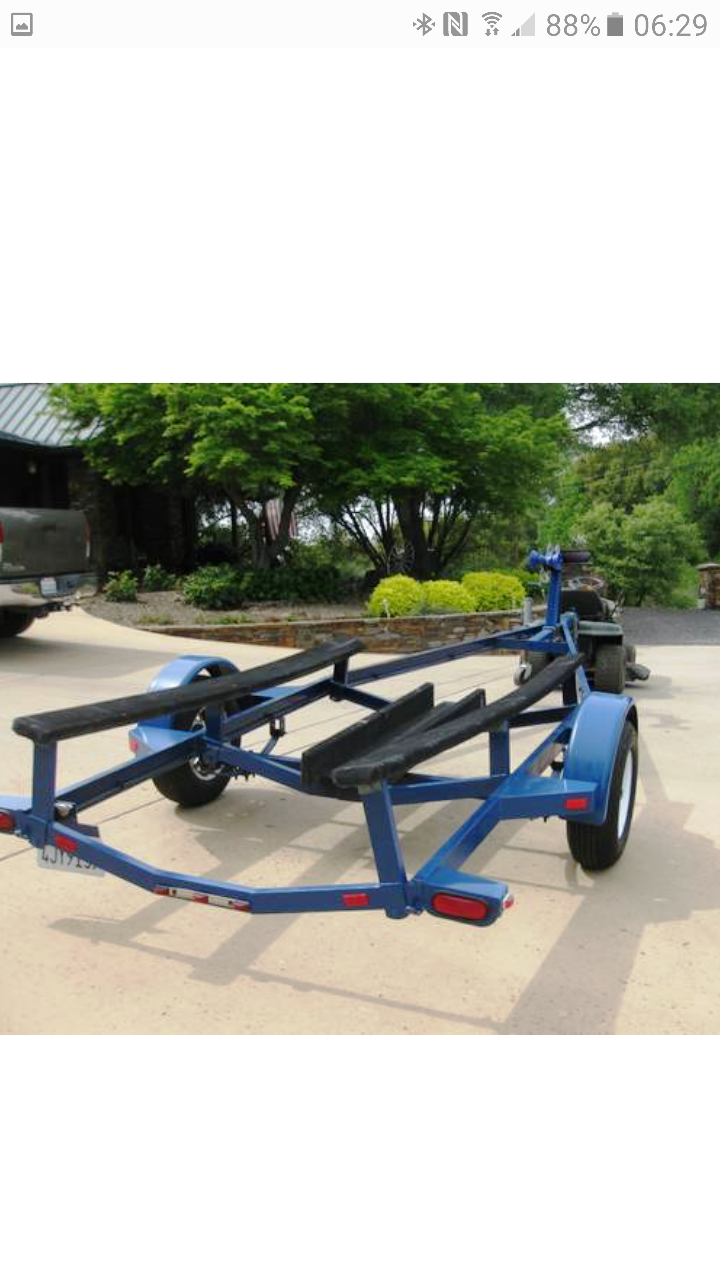

    I was told that the Duffy should not sit on the keel because the weight could damage the keel. I purchased a boat trailer for my Duffy but I am concerned that the keel could be damaged. Can you help. Does the attached trailer look ok for a Duffy. The previous owner said he hauled his Duffy on it. Thanks, Jim

    Do you ar any other member have any info from Duffy about the boat not being designed to sit on its keel. I am used to sailing boats which tend to have ballast in the keel and so are strongly built down there, so while I can understand that it might be true that the Duffy is lightly built in the keel area I am keen to get the facts. My concern is that I am about to buy a trailer and to me it makes sense to have the weight on the keel with the side beds or rollers merely holding the boat upright. I don't want to make an expensive mistake.
