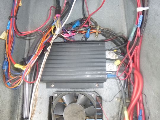

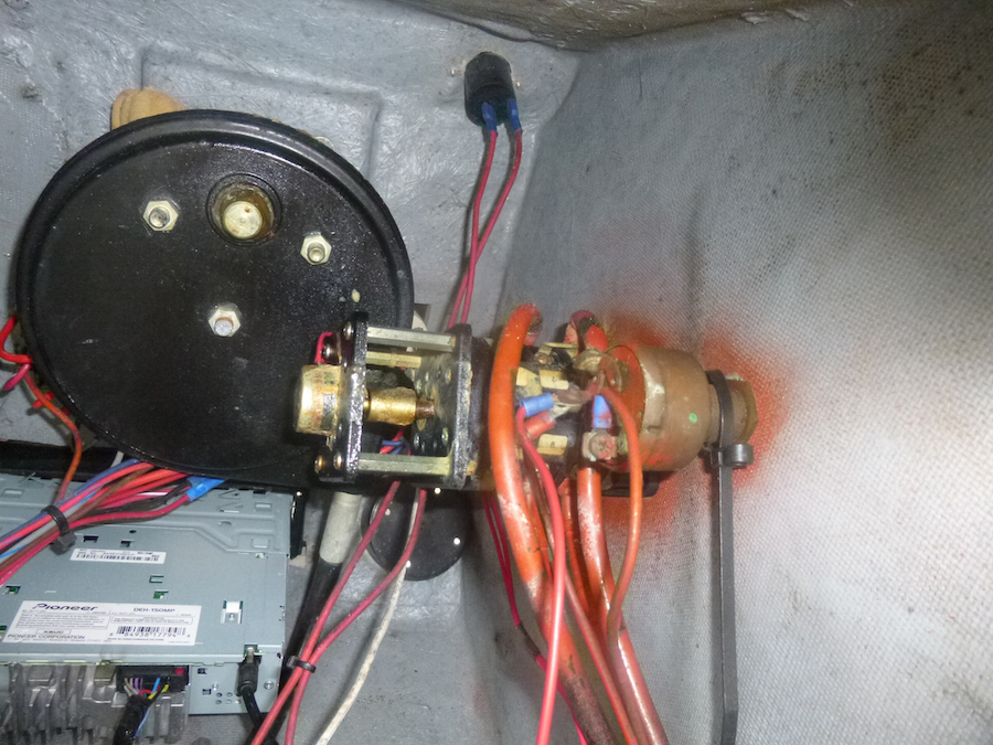

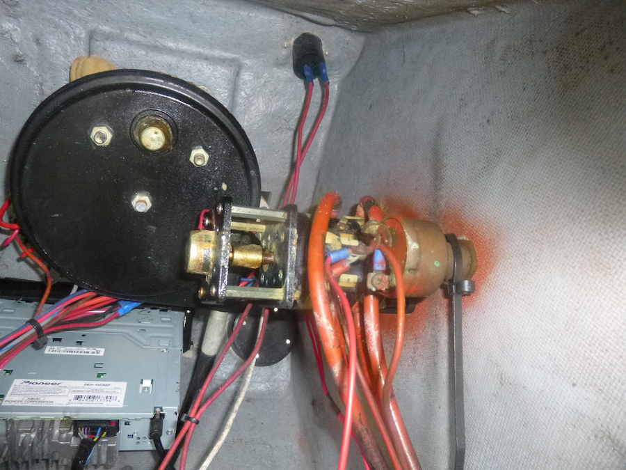

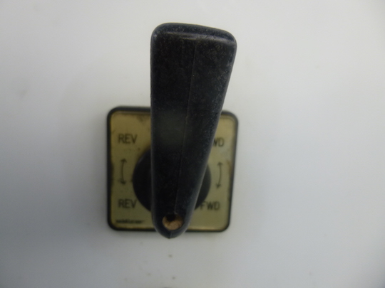

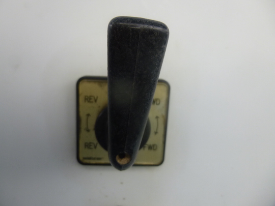

    Thanks for that! Here is the barely helpful response from Duffy after I sent them the same photos:
    Thank you for the photo's.
    Unfortunately all of the parts your are inquiring about have been discontinued since 1998. In this situation we recommend upgrading to the Duffy Infaspeed Controller System (part # SMI-215-ASSY) for $2,400.00 plus shipping. The assembly includes the controller, the actuator and all of the necessary cables, there is a 7 business day lead time from the date of order for these parts.
    Regarding your existing parts I was not able to find the original parts numbers only the vendor information. The Black controller was made by Curtis Instruments, there should be a metal label on the unit with a part number or serial number that could aid in your search. The actuator/barrel switch was made by EPC (Electric Power Controls) they are located in Long Beach, CA.
    If you would like to place an order or would like additional technical assistance please contact our Newport Beach Parts & Service Office (949)650-4633 and request to speak with a technician.
    Thank you for choosing Duffy Electric Boats!
    I am going to remove the "switch" assembly to see if I can get any useful ID from it.

    JIMG, I would not say Duffy's email was useless, I think it's quite helpful. Start calling those companies (Curtis and EPC) that manufactured the parts and they should either have something on the shelf, be able to rebuild the part, or be able to point you in a better direction to retrofit something. They should also be able to tell you how to test the parts.
    You have to understand that at best you're dealing with parts not made in almost 20 years.

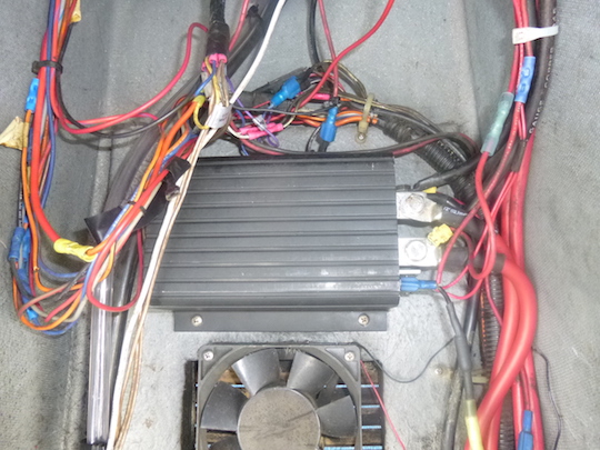

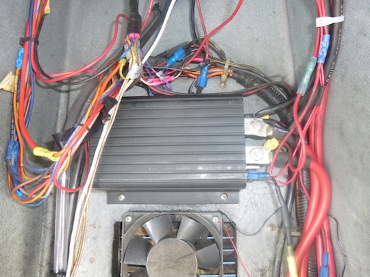

    OK, I guess I was expecting more. I have now tested the EPC switch and found that the rheostat part is working with v
    I have also found a manual for the Curtis controller (online) and wiring diagrams. I am convinced that I have a wiring error. What I am experiencing is full throttle no matter where the handle is, forward and reverse as if the rheostat were bypassed. Any thoughts?

    Could be the controller.
    On my boat, Duffy charge $1,600 for the controller but I found it on-line for $500 new and $350 refurbished. Had to send it to Duffy for programming to match the boat however, they charge $99 for the job,
    Also keep in mind that Golf Carts and Fork Lifts have the same equipment as Duffy, but for a lot less money.

    My boat is fixed!! The secret is that the voltage in and out of the potentiometer is 36 and not the 12 Duffy's diagram shows. Don't have to do those crazy markups!

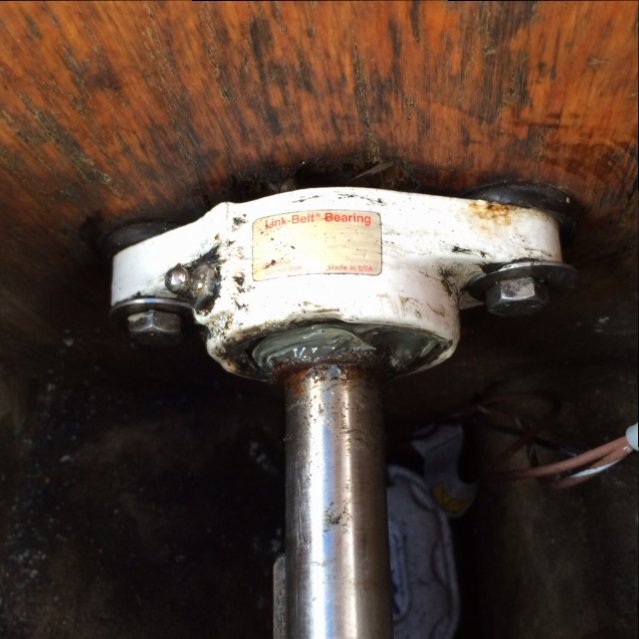

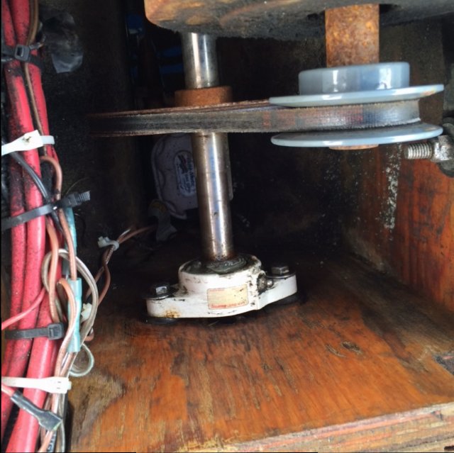

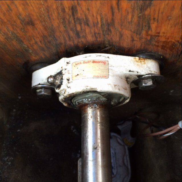

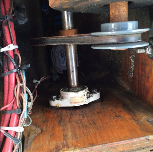

    I need to replace the belt on my 1990 20' Duffy. Boat is on a lift. Do I simply slide the shaft aft after "unbolting" the thrust bearing? How is the thrust bearing likely to have been mounted? Backing plate? Nuts on the bolts? Access? TIA

    You could also leave the thrust bearing alone and take the shaft out of it. HOWEVER, you might want to just leave the shaft in the thrust bearing if that is a sound connection and just remove the trust bearing. If its like mine there are only two nuts and the whole assembley should slide back just enough to get the belt off and the new one on.

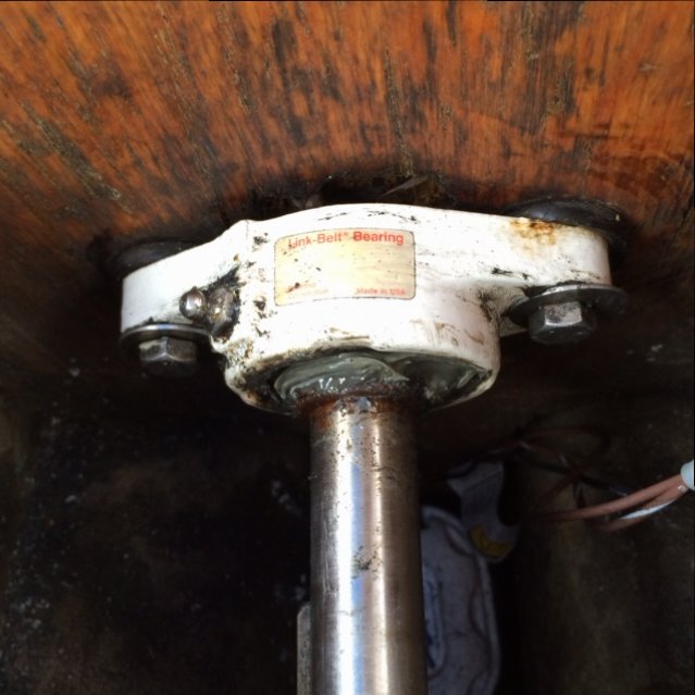

    Thanks for that! Here is what I see:
    I can see from my photos that the pulleys are slightly out of line too. The bulkhead on which the thrust bearing is VERY solid in spite of the appearance in the pic. So, just the 2 bolts and then care to support the shaft and slip the belt off?

    Looks like that is it.
    I had a hard time getting to the nuts behind the bulkhead, had to clamp a pair of wisegrips on the nuts. (Ouch :) )
