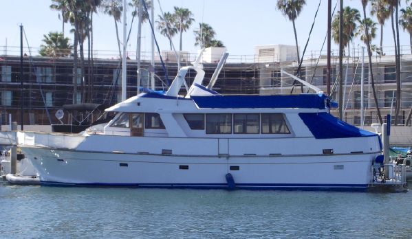

    They are both the same year boat , 1980 60’ lein hwa ,the one with side exhaust is a dive charter boat in LaPAz Mexico , the other one with the dry stack was in marina del Ray for 15-20 as a private yacht named “ sprit ‘....how much of a foot print do under water mufflers take in a engine room ? With modern technology is there away to really shrink the size of the dry stack in the salon? Ceramic coating? Better insulation? There is fire suppression sprinklers in there ,could I get it down 2’x2’ or smaller? Running the exhaust thru the transom woukd be a huge job and I believe you couldn’t get them past the fuel tanks

    From your photos my statements are an educated guess at best. (SWAG) I see a large diameter Blue silicone hose all the way aft that looks to be close to the inlet of the muffler and that would lead me to believe the system would be wet but the lagging on the can says "dry" to me. The photo of the vessel on anchor has a waterline exhaust discharge fwd. just under or aft of the pilot house door so the discharge of this muffler is facing fwd and that would add to back pressure issues if this were a wet system. The forward facing outlet discharge on this system is an anomaly for the running angle of any vessel. Call a marine exhaust company in your area and have them give you a few good options for this vessel.

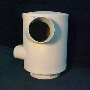

    I assume your picture is similar to a resonator you are talking about. Designed above my pay grade.
    However, I have been on many older boats (glass & alloy) with 3412s, 3208s, 71 & 92s that at or just after the down turn of the dry exhaust, use a dump can to mix and cool the exhaust gasses with raw water, then thru some humped hoses, straight into a near vertical pipe fastened to the bottom of the hull. The larger engines with a smaller pipe out the sides or the stern.
