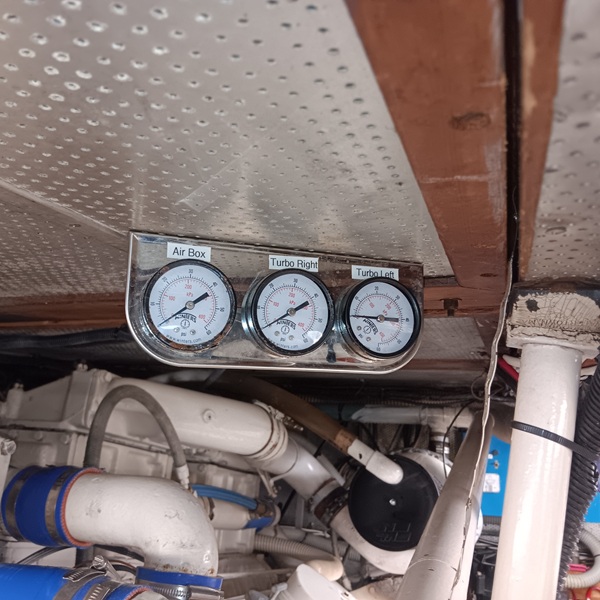

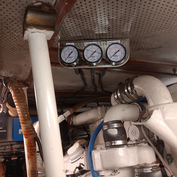

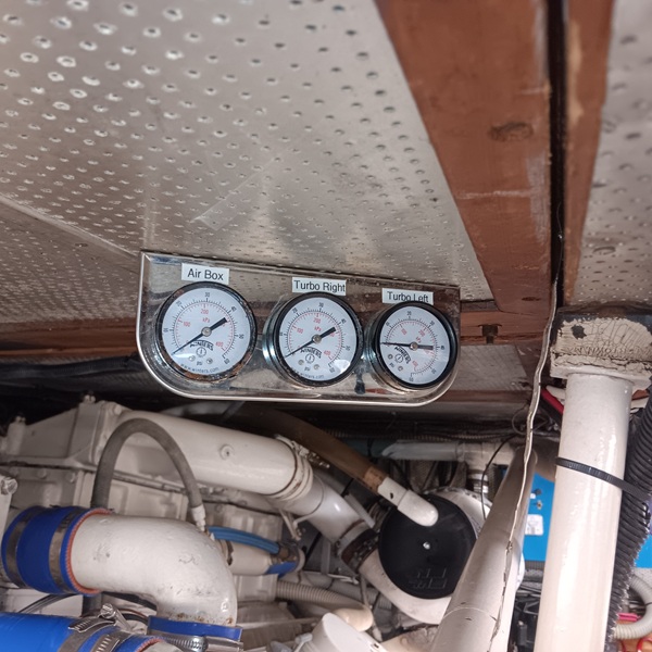

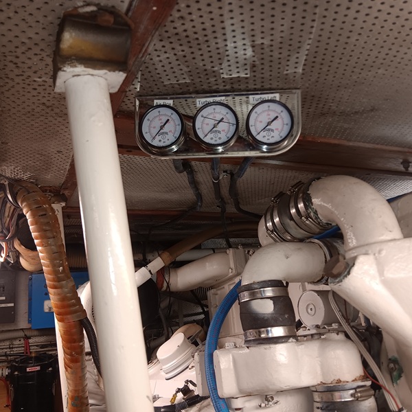

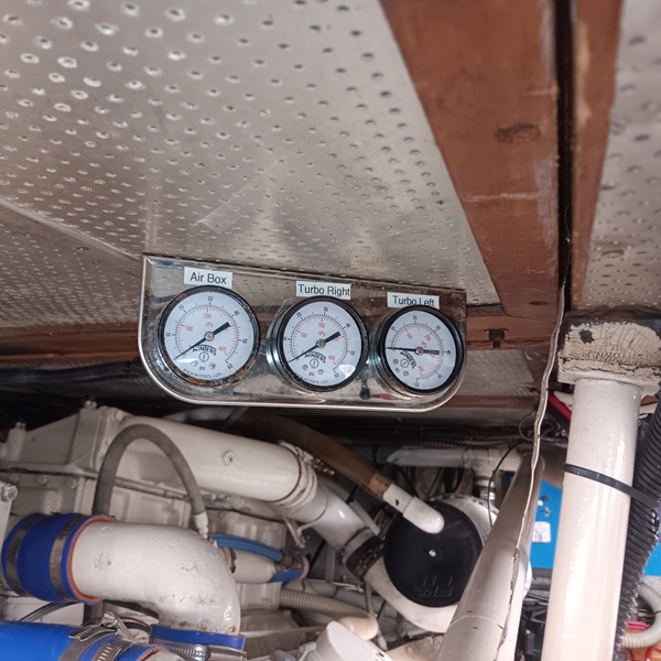

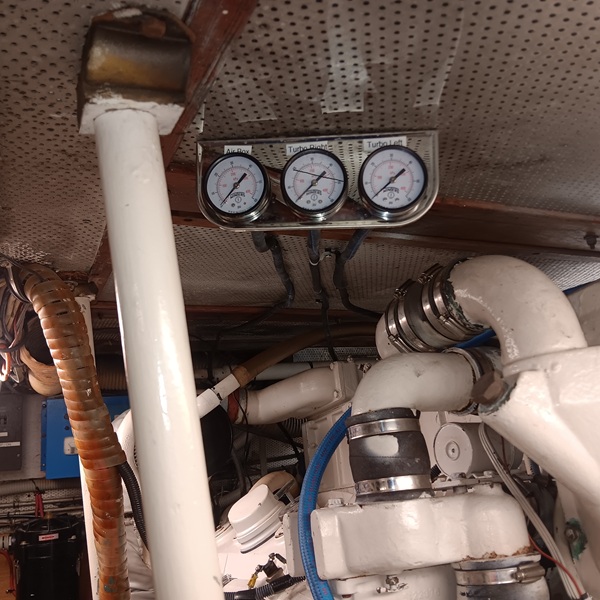

    In the mean time, I took some pictures of my charge air pressure gauges.
    My air pressure gauges are great and when one turbo started failing, I knew quick witch one.
    I do recommend you install some fuel pressure gauges, at least for SOP. Helpful for smarter fuel filter replacement schedules.
    Please, please consider installing at least some fuel vacuum and pressure gauges.
    They do help a lot.
    When it comes time for modulator tuning, you may have the gauges already installed and make smarter adjustments.
