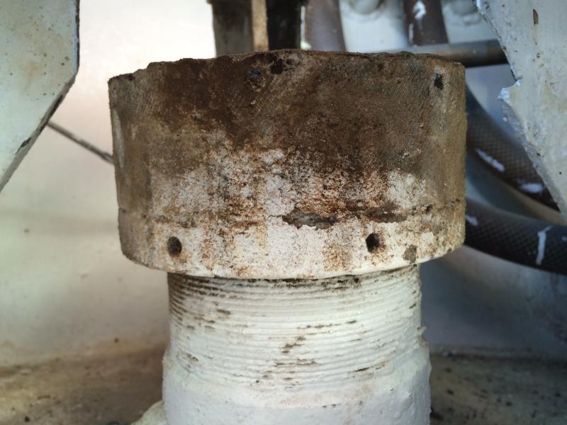

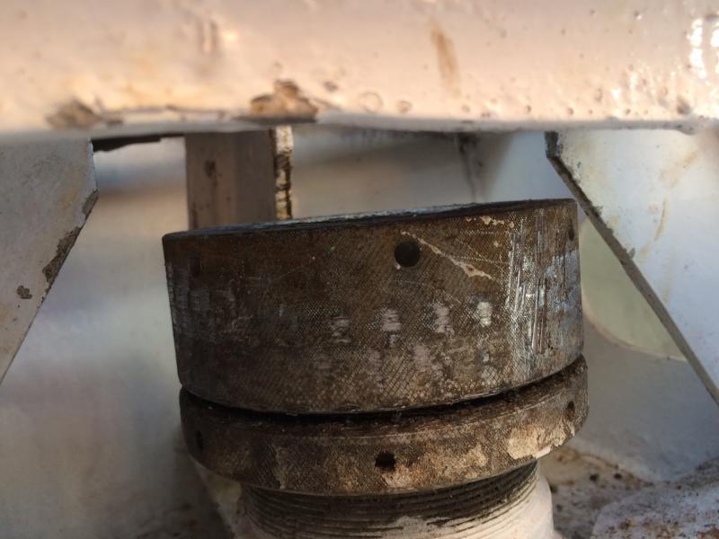

    The Port Shaft and Coupler made straight at the shop and ready to go in. Pitting looks less than expected so going with PSS Shaft Seals.
    We decided to replace the cutlass bearings x 4.
    The new rudders are also ready to go in, but I'm told the Aluminum Packing Nut for the rudder shaft need replacing.
    Does anyone know where you can find aluminum version of these?

    I had that problem on an old 44 Striker. Ended up putting a LasDrop system on and never worried about it again.
    A better machine shop can make one but it's bux that can go towards a long term fix.

  18. jhall767
    jhall767 Senior Member
    Jan 14, 2010
    340
    Middle River MD
    I have the same rudder setup on my 44 Striker. Very easy for a machine shop to make. Just bore out. Cut the threads and drill a few holes for the pin wrench. Just be sure to tell them it is probably BSP pipe thread not American. Contact me if you need any other info on these boats.
