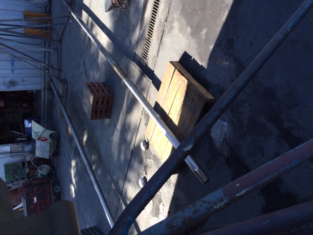

    Shafts are finally out. Engine alignment indicated a bend in coupling or shaft. Shafts go to the shop on monday
